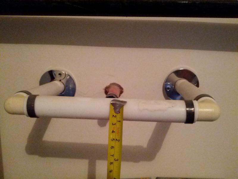

    Our house is 2 years old and I think we have PEX plumbing. I was reading about "sharkbite" type connectors that might work, if I can just cutt off the existing loop and connect that adapter then connect it to the Fleck bypass valve that should work. I'm a little hesitant to use those adapters though, since all the water in the house will be going through it.

    I have used the sharkbite on pex before and they work great. Once you cut it, a very light sanding around the edge to deburr it will help seat the o ring. Let us know how it turned out.
  7. #52
    6,790
    And don't guess which line/side the water flows from, cut the loop and hold a bucket up under the two ends and turn on the main valve. The line the water comes out of goes to the inlet of the by pass valve.

    Pipe sizing is annoying. The online vendor I got my water filter from said that everything is measured internal diameter, but it seems to me looking at all these fittings that everything is actually measured using the outside diameter of the pipe.
    Tubing that is labeled 1" is clearly 1" outside diameter. It seems to me that I have 1" outside diameter tubing and need 1" compression fittings to go over the outside of it. I was under the impression I needed 3/4" fittings since it seems like I have 3/4" inside diameter tubing.
    I got confused by some of the fittings at Home Depot and they didn't have two of the ones I thought I needed, but now I'm not so sure. I'm going to take the bypass off the valve and bring it down to the store tomorrow or next week and test fit things. Unfortunately I don't have a spare piece of pipe to bring or I could rig it all up in the store to make sure it works. But I measured the pipe and it's clearly 1" on the outside.

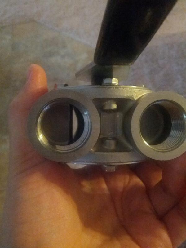

    I assume the tubing in my picture above is PEX? It did not look quite like the PEX piping at the store, it appears more rigid to me than the stuff at the store. I see an identifying mark of PEX1006? on some of the piping but nothing else that makes any sense to me. It appears to be just over 1" outside diameter and the fittings appear to be in the range of .8" so it must be the 1" PEX if it is PEX tubing.
    I was looking at the Fleck bypass valve and the opening looks ridiculously small when set to the service position.
    This seems like it would be a huge bottleneck to water flow?
    Maybe next time I embark on a plumbing adventure I'll just hire a plumber!

    I'll weigh in on the PEX diameter thing. The OD of pex, cpvc and copper used for potable water is all withing ANSI standards for size and therefore Sharkbites will work on any one of them.
