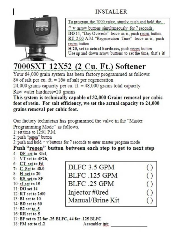

    Since many of you were very helpful, I thought I report back after couple months of use.
    First, I ended up getting the 2cu ft (64K) Fleck 7000sxt with 32mm distributor tube.
    It has gravel underbed with 8% cross link ResinTech resin.
    It is connected with 1.5" x 1.25" brass connector available specifically for this model.
    The system has following settings:
    DF GAL
    VT dF2b
    CT Fd
    C 64
    H 15
    RS SF
    SF 15
    DO 21
    RT 2:00
    B1 10
    BD 60
    B2 5
    RR 10
    BF 16
    FM t1.2
    Some of the observation after using it for 2 months.
    1. Water pressure is just fine and I have not experienced any loss of softeness even when running dishwasher, laundry, and couple of showers at once. We have not used our large bath tub while doing other things but as mentioned in the above post, we don't use our large bath tub regularly.
    2. As suspected, we don't use water as much as the typical household. Initially, my water softener was regenerating every 14 days via the override as we only used 2,400 gallons every 14 days while this tank provides 3,600+ gallons capacity per regeneration. As you'll notice, I have reset the Day Override to 21 days based on discussion here, advice from vendors, and other forums. I know this is somewhat has differences of opinion but I think it's not a significant risk to foul the resin with 21 days regeneration cycle. I'm also glad that I didn't get 2.5 cu ft (80K) tank as I think it would have been way too big from capacity stand point.
    3. I have the Brine Fill set at 16 which I believe is a equivalent of 6lbs/cu ft of salt usage per regeneration. Based on some feedback here, is this illegal in California? Do I need to change it back to lower salt dosage/BF settings?
    Thank you all again for your help.
    My family is really happy with this unit.

    Some of your settings are off. The "64K" capacity is theoretical, not real world. See the picture below for proper programming. A 65K unit is typically rated for 48K in a residential application, or less. California requires the efficiency ratings exceed the programming listed below, but... this is the most popular setting for high efficiency in both water and salt, while maintaining very soft water.
    DF GAL
    VT dF2b
    CT Fd
    C 64 48
    H 15
    RS SF
    SF 15
    DO 21
    RT 2:00
    B1 10
    BD 60
    B2 5
    RR 10 5
    BF 16 22
    FM t1.2
    This is assuming that the BLFC and injector are correct. Take a look at the back of the valve, you should see a small white sticker that indicate the BLFC and injector size. you should also remove the small grey clip from the brine line and check to see if the BLFC button matches what the white sticker says. It should be a .25 GPM, but a .125 will work just as well. It should not be a .5. The injector should be a red #0, but a #00 will also work fine.

    Thanks Dittohead.
    I knew in my mind that 64K capacity is theoretical.
    I just didn't put 2 to 2 together by changing the setting accordingly.
    Thanks for your usual advice and I'll make the necessary changes to the settings.
    Yes, my unit has .25gpm BLFC connector.

    Dittohead,
    My 2.0 cu ft system will be install soon. Do I use the same cheat sheet from above post? I just re-set the hardness base on my water test result. My water usuage were 3 adults + a baby. I assume the hardness "H" I need to change to my water hardness of 25 and BF setting at 22 or different amount?
    The salt time setting 0.25 BLFC setting were "30" for a standard 48,000 grains.

    The cheat sheet above will work fine, but many people set the salt setting lower. Personally, I prefer to have a slightly less efficient system in favor of the higher quality of water the system will produce. It all depends on your exact water source, competing ions, etc. If you want to program the system to use 20 pounds less salt per year (approximately $2 savings), let me know. I can post the cheat sheets for 4 and 6 pound settings.

    I prefer water quality over salt saving... lol I believe the above setting were for 8 lbs setting? what are the 6 lbs setting like? 16?
