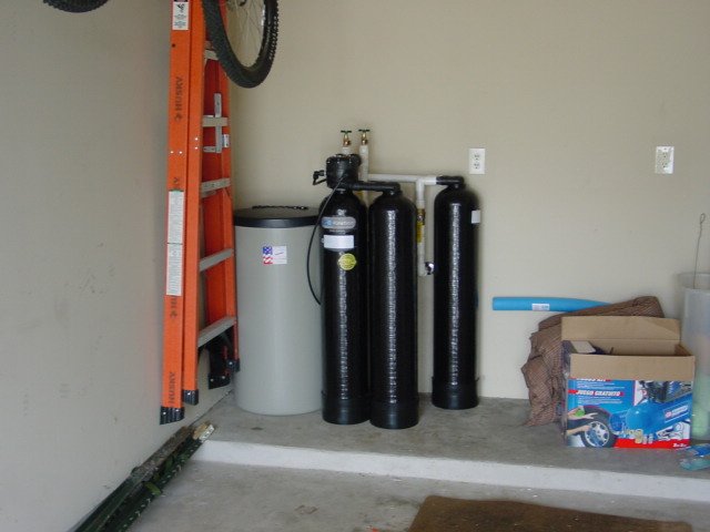

    Why not try Kinetico? Name:  2060无电2.jpg
    6,358
    Kinetico!! That is a terrible choice, over priced and not near as good as the hype says it is. DIYers can't get parts when needed.
    The OP needs to buy online and install it himself or hire a plumber that will follow instructions.
