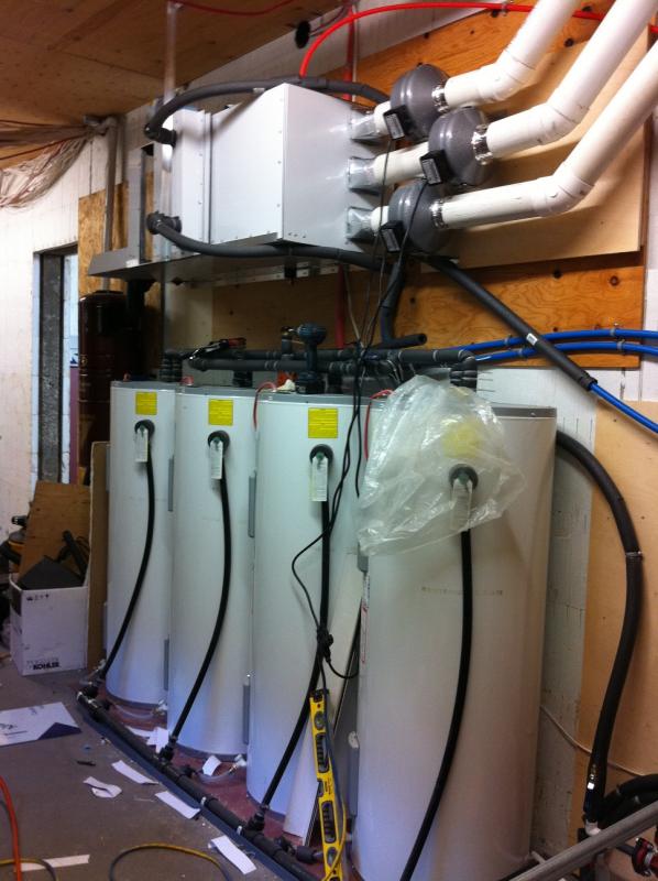

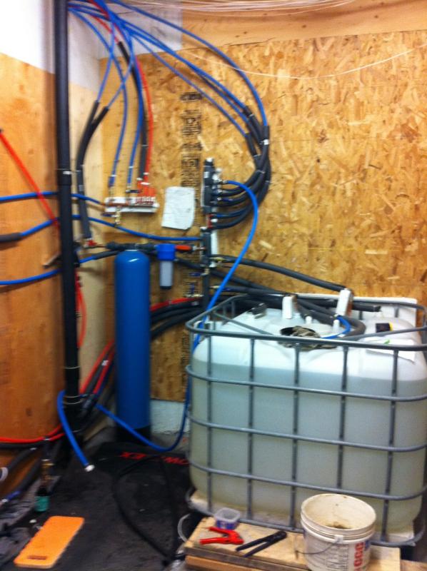

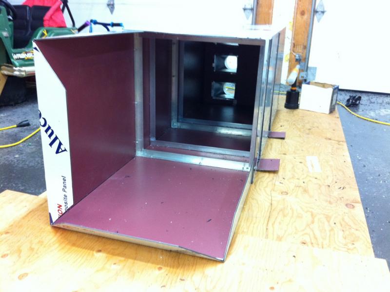

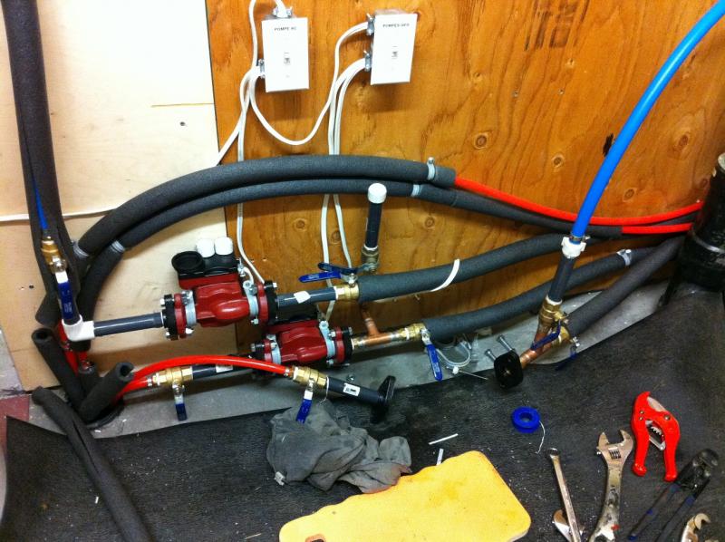

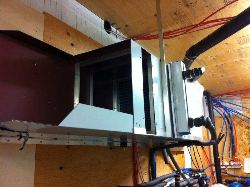

    DIY Junior Member Jin's Avatar
    Jul 2012
    Montreal
Size:  67.2 KBName:  image002.jpg
Size:  53.6 KBName:  image003.jpg
Size:  81.0 KBName:  image005.jpg
Size:  73.1 KBName:  image009.jpg
    here are some quick pics
