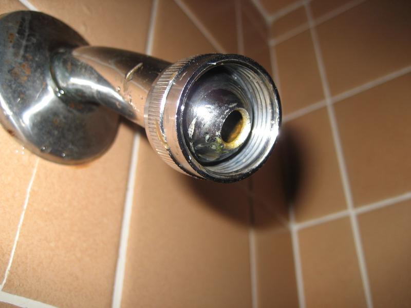

    My parents bought an old house from the late 1950s, complete with a shower arm with a ball end. My mom would very much like to have a handheld shower head, but of course no one makes shower heads for our type of shower arm anymore. We would love to just change out the shower arm to the standard 1/2" one, but my dad is afraid we'll break a pipe in the wall (which we just can't afford right now).
    The problem:

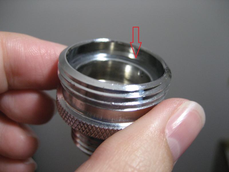

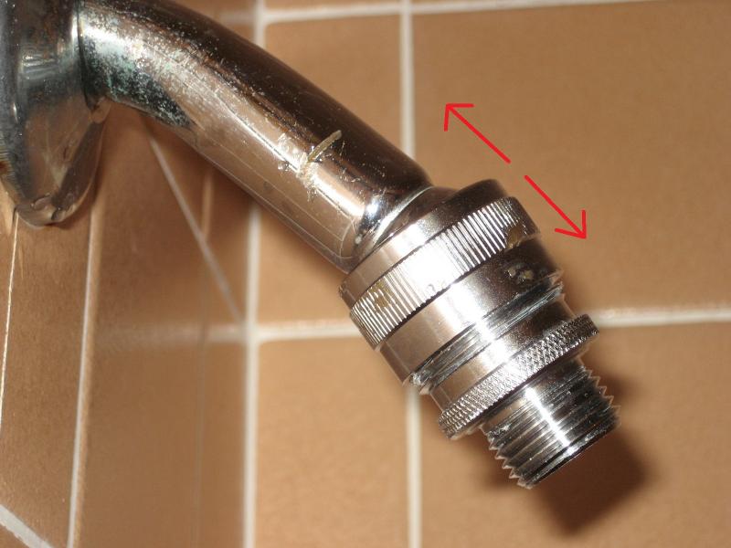

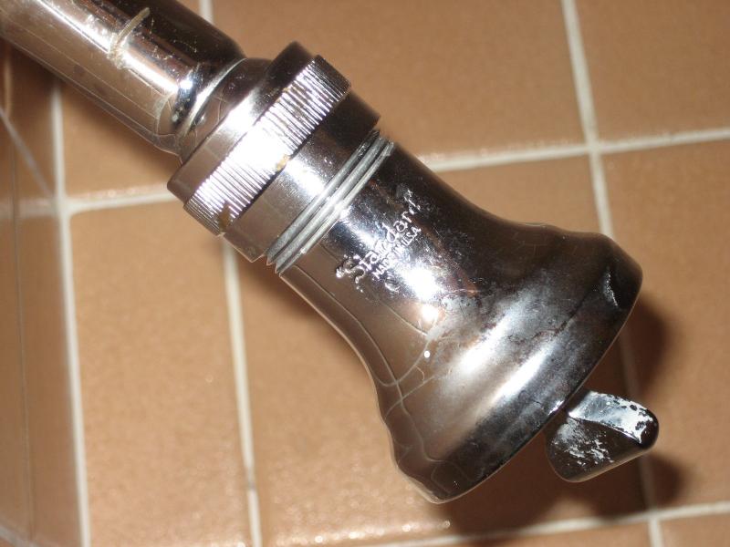

    I went out and purchased an adapter for our 1950s American Standard shower arm, which changes it from a ball end to the standard 1/2". When I screw the adapter + the new shower head into the captured nut, it only screws maybe halfway down the adapter's threads. This results in an extremely loose-fitting captured nut (when the original shower head is screwed in, the captured nut fits snugly against the ball end), and water squirts everywhere from above the captured nut. The only way to get a decently tight fit between the adapter and the captured nut is to stack about 4 or 5 o rings between the adapter and the ball end. My problem with this method was that if the o rings twist or shift, water comes shooting out again.
    I do get really good pressure in the new shower head (even with the extra spray of water from the shower arm), but I'm afraid the water will leak back into the wall and cause rotting.

    The adapter (and where the o rings sit):

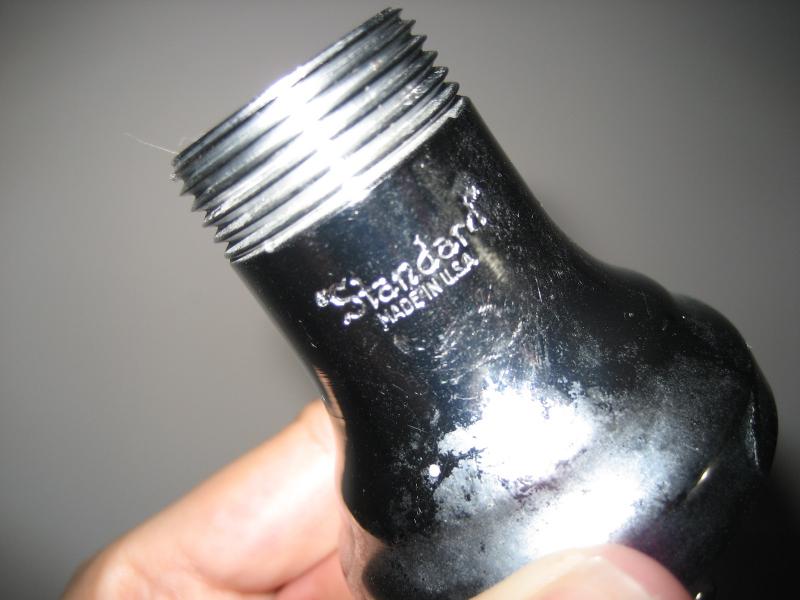

    The old shower head:

    The adapter screwed in (only 1 o ring inside):

    The old shower head screwed in:

    There were a few common ( all different!) ball end shower arms. AmStd and PricePfister were two. You may have the wrong adapter, but the best idea is to replace the shower arm.

    Do you happen to know if "Standard" (how my old shower head is marked) is how American Standard used to mark their products? The handles that are with this shower were confirmed to be American Standard in another thread, so I'm hoping it's a matched set.
    We really would love to change the shower arm, but we can't afford risking a broken pipe right now.
    9,003
    Quote Originally Posted by gemgem View Post
    Yes, going way back....I think pre-early 50's, the name was Standard. That badge was revived on some retro items in the early 2000's. I still suggest that you stop fighting city hall on this and just replace the arm.
