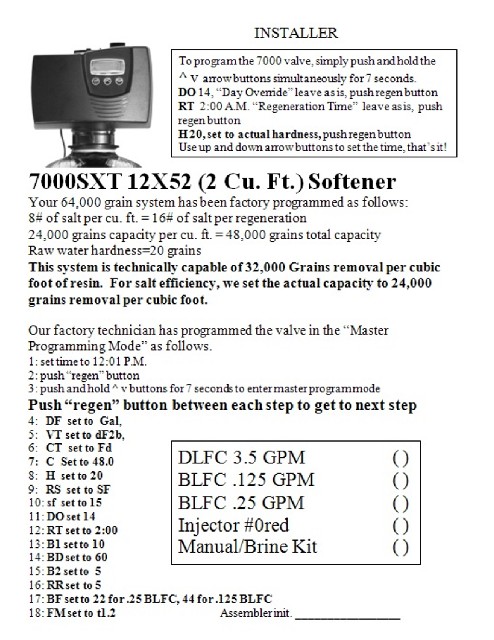

Remove the grey clip from the drain line and pull out the black elbow. Inside is a rubber flow control button. Look at the numbers on it. Assuming you have a 12" diameter tank, a 3.5gpm button would be better for your application. I will post a programming cheat sheet on monday, this is a simplified master programming guide specific to your valve.

I am 90% sure the 5.0 is the correct button for the turbulator.
Hope this helps,

Thank you very much Ditto. I just set the head to those specs and will see what happens. If it's not too much to ask how much salt and how many gallons of water should I put in the brine tank to start with?

5-8 gallons of water, fill the tank full of salt. There is no right or wrong answer, and I am sure others will try to argue their formula for start up is better, but honestly, this is a simple way to start up the system. The system will automatically adjust the salt water levels correctly after that. Fill the tank full of salt, and you can ignore it for many months. I usually let my system run low on salt once a year, then clean and sanitize the brine tank then.
