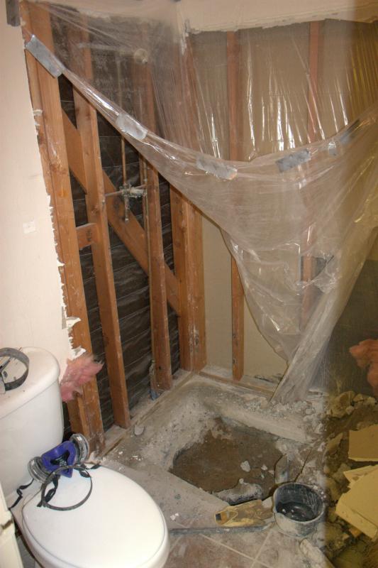

    I am converting a shower to a bathtub, and need to move the drain. As you can see in the pictures, I have already removed the shower, and ripped out some of the concrete slab. Instead of digging up more concrete (which seems to be in two layers, is quite thick, is reinforced, and is difficult to remove with a sledgehammer), I would like to:
    1) cut the existing pipe so that I can
    2) install a 90 degree elbow in it and
    3) use a 1.5 inch pipe to reach the tub drain, approximately 1.5 feet from the elbow.
    4) install a p-trap
    5) insert a 12" plastic box
    6) pour concrete
    Is the 90 degree elbow ok?
    Also - in order to access the tub to connect everything up, I am going to have to cut a hole in the wall. This is an exterior wall in the back of the house. I'd like to install an access panel to cover up the hole - so that I can get to it later if I need to. What do I need to keep in mind regarding this access panel?
    Note the vent behind the toilet that is barely visible in one of the pictures.
    Also, the shower was 60". I've measured the space, and it is about 60 1/4" wide, so a tub should fit there fine.

    There is a lot that needs to be done here.
    1). That poly under the slab needs to be mended at the end.
    2). I would keep everything in 2" and change to 1 1/2" just before the T where the drain and overflow connect.
    3). 90's are not allowed unless they drop into a vertical line
    4). I think the make bends can not exceed 135 degrees.
    5). You need to break up more concrete against the back wall most likely. Get your tub in rough position with the drain and overflow dry fit.
    Good Luck.

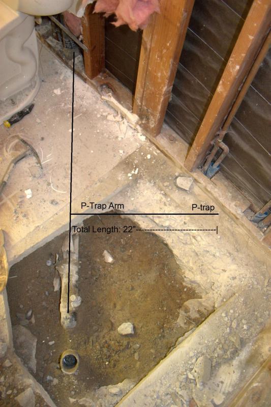

    So would this be ok?
    Name:  over drain - Bathroom - with 45.jpg
    14,207
    You can use a 90 on the trap arm horizontally.
    The tub waste and overflow set right up against the 2x4 stud wall. More concrete will need to come out there.
    What you have drawn there is for the drain in the tub, the p-trap will be against the wall, allowing the overflow to mate up at the overflow position.

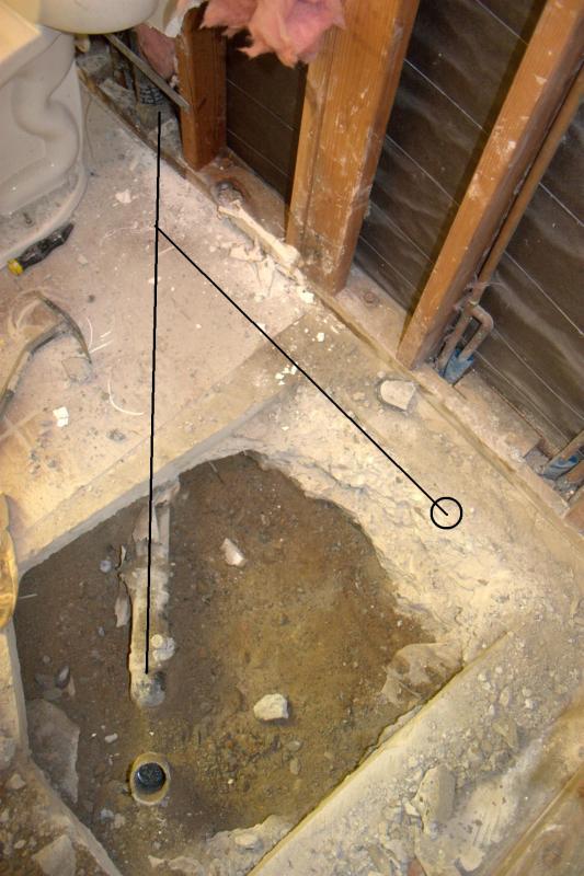

    DIY Junior Member Jon Lehman's Avatar
    Jul 2012
    Here's what I understood you to say...is this right?
    Name:  over drain - Bathroom - with 90 and p-trap.jpg
    Last edited by Jon Lehman; 07-24-2012 at 09:12 AM. Reason: posted the wrong picture
    14,207
    That should work.
