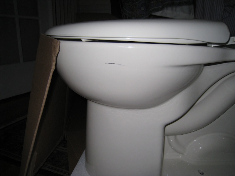

Hello again,
I just wanted to check in with an update. At long last, I got my replacement toilet (my brother-in-law, who works for a plumbing manufacturer, is helping me get these toilets through his contacts at a local distributor which is why it took so long). If you can believe it, the replacement toilet has a defect too. It has some sort of metallic smudge on the outside of the bowl (see attached photo). I have tried to clean it off with a Mr. Clean eraser but it didn't help much, if at all. At this point, I've thrown in the towel and won't go through (or put my brother-in-law through) another return. If anyone can suggest something to clean off the metallic mark, I would be very grateful.
Needless to say, I am appalled at American Standard's lack of quality control and will never select one of their toilets again.

After trying baking soda and various cleaners, it was Soft Scrub with Bleach that finally took off most of the metallic mark. Thanks again for the help, SamC.

I had no idea what to recommend, but I was sure hoping that after what you went through earlier that one of our contributors would have a great solution. And, great forum that this is, SamC came through! I, too, thank SamC because I now have an idea of what to use on some other problem stains on one of my older toilets. Great job, SamC!!
SD -- I hope the rest of your install goes well. A lot of us have been following your saga with interest, so feel free to shoot and post us a photo when it's finally in!
