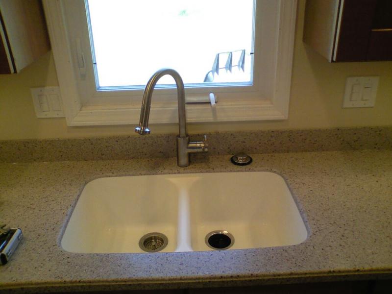

    i just installed that kohler kitchen sink drain a few weeks ago. i didn't like that system that much.. I had trouble getting the nut tight enough with a little over hand tight, and then using the screws like the directions said. i also noticed it not being uniform pressure. i think i had too much putty under the rim too. so i got it as tight as i could get it with the nut, then pushed down with my hands on the flange ontop, retightened, pushed again, straightened the nameplate on the flange and then locked down the screws. to get them a little tighter than my screwdriver liked, i used my dewalt impact screwdriver. all the screws were straight and even after doing this.
