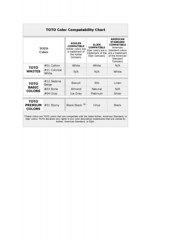

    21,405
    Default Toto Color Compatiblility Chart
    This may help....doesn't look like there is a good match.

    So I did some research on Google, and god bless it, Google brought me right back to our beloved forum. The answer seems to suggest that there is hope...that Toto Bone is comparable to A/S Bone.
    Here's what Terry said in 2010 on this question -- I quote him gingerly, because his impression may have changed, but he was pretty authoritative and comprehensive at that time:
    "American Standard: Bone
    Kohler: Almond
    Toto: Bone
    Mainly sold in the 80's
    American Standard Linen
    Kohler Biscuit
    Toto Sedona Beige
    A more recent color choice
    American Standard old White
    Kohler White
    Toto Cotton White
    American Standard New White, within the last few years.
    Toto Colonial White"
    It's from posts 7 (the question) and 8 (Terry's answer) in this thread. See also Terry's little balloon addition to the question in post 5 in the same thread.

    TOTO Bone is the match for American Standard Bone.
