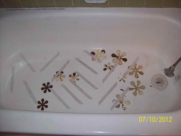

    Hey all, I have a 40+ year old condo in Houston, Tx.
    In our hallway bathroom the 1970s flower shaped non-slip appliques have fallen apart and
    come up, but the adhesive part is still stuck down to the tub. I posted a photo.
    I've tried to peel them off but they're stuck down firm. I don't want to scratch the enamel.
    I believe it is enameled cast iron but perhaps steel.
    I put some regular nonslip strips on there, but the water gets underneath where they pass
    over the old appliques and they're lifting off.
    Is there any way to fully remove the old applique backing from the tub without tearing the enamel surface up?
    Any advice,
    Henry

    Have you tried GooGone? How about mineral spirits? If that doesn't do anything, maybe lacquer cleaner?

    I'm with Jim. Xylenne, Lacquer thinner and Goof off. They are all very smelly stuff.

    I'll start w/ the goofoff and see what happens. It's the least noxious methinks. There is zero ventilation in that room and the vapors can concentrate too easily. I'm extremely sensitive to inhaled chemicals of any kind; they put me out of commision for days if I breathe even a little.
    I have one of those OSHA approved respirators that I used when I was grinding cement a while back, but I need
    new cartridges for aeresols and/or vapors I guess.
    Should I be using a razor or something to get the stuff off the enamel or will goofoff make the
    stuff peel up do you think? I hope to not damage the enamel of the tub if I can avoid it which is why
    I have not tried a razor so far.

    The main ingredient in Goof Off is Exyelne. If you do not have a proper mask or ventalation you best hire someone to do it for you.
    A flat razor may do the job.
    Is there no window in the bathroom?

    Goofoff and GooGone are two different products. GooGone is primarily a citrus based product (and yes, it does smell, but like concentrated lemon/lime). The GooGone I have works on many adhesive labels (price tags, etc.) and some other generally hard to get off stuff and may not be as strong as you need, but it wouldn't hurt to try. It's hard to say what solvent will disolve and soften that adhesive...some are quite resistant to most common chemicals. Sounds like Goofoff is a lot stronger - I'll look for some if I get a situation where the stuff I have doesn't work. No doubt it works for what it is designed, but not all adhesives are created equal!
    As to contractors and smell containment...for those that don't read and heed the warnings, I think that after a few times, they've burned out enough brain cells that they don't care and don't notice!? In the states OSHA has some clout, but they need a complaint or a random on-site inspection to catch this type of problems...not that many inspectors out there.
    Anything sharp you use, you'd need to be very careful that you didn't scratch the surface. Another thing you will likely find out is that once you do get it off, the color may not match anymore.
    While some people swear by them, there are more horror stories about tub/shower liners than glowing reports. They don't tend to last all that long. The biggest issue is the seal at the drain...if not done perfectly, you can get water between the original tub and the liner that squishes when you walk on it. That stagnet water can get pretty ripe.

    I actually ended up with the googone first. I'll see what happens. I took a small sniff of the goofoff and my head went swimming (still is a little bit three hours later) so I put it back hence trying the googone first.
    I bought normal paint/insecticide/organic vapor resiprator cartridges for my mask just in case the smell becomes a problem with the citrus stuff. I've used citrus based paint remover "citrus strip" before and with worked well on my stair railing which the previous owner varnished several times over. If this googone is even half as good it'll work. I'll know shortly. I got a 3" wide scraper for glass which I hope will work OK. I'm not worried about color as long as it's not too different and it lets me put new non-skid strips down so they won't lift.
    The main reason I'm looking to remove them is that the top pieces have cracked and float into the drain clogging it in several cases along with their interfering with the non-slip from sticking.
    Otherwise I would leave them alone. If the googone doesn't work I'll have to try the goofoff.
    If I thought that citrus strip wouldn't harm the enamel of the tub I'd use that.
    But it says it removes all paints including enamels. I would be concerned it would hard the tub.

    Solved! The googone worked and perhaps wasn't needed afterall. The 3" razor worked pretty good on it's own but it went through them like a hot knife in butter. A few scratches but they're barely noticible. What is noticible and I think avoidable is the shadow of the appliques is still there. I can live with that though.
    Once I put new strips in there the shadows should be less noticible. The last thing is the citrus has left a film that
    is slightly oily. I'm going to have to use something that neutralized oils to clean the tub before I use new non-slip strips.
    Regular bar of soap took it off my hands so I'll just try some of that.
    Thanks again. I think I'm done with this.
