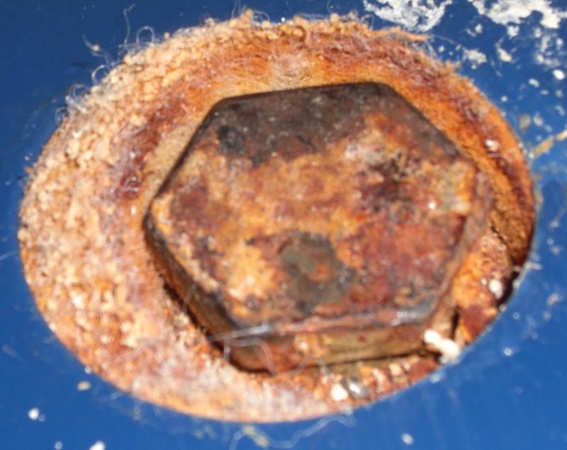

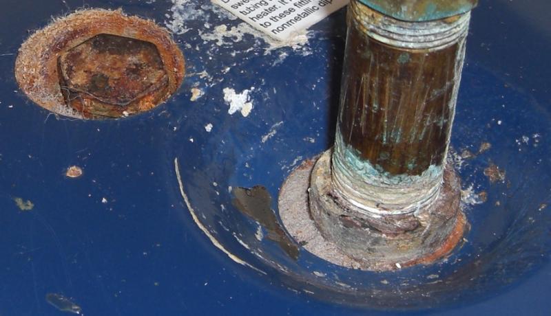

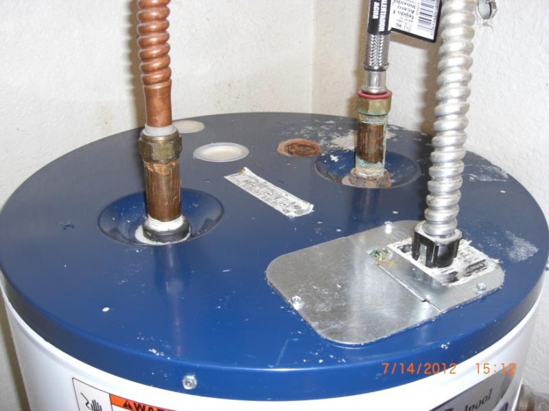

    This electric hot water heater was installed four or five years ago.
    My first question is about the rust-colored corrosion shown below:
Size:  53.9 KBName:  1.jpg
Size:  54.6 KBName:  2.jpg
    Should I use a paste made out of baking soda or something and (try to) scrub this stuff off, or should I contact the landlord, or... ?

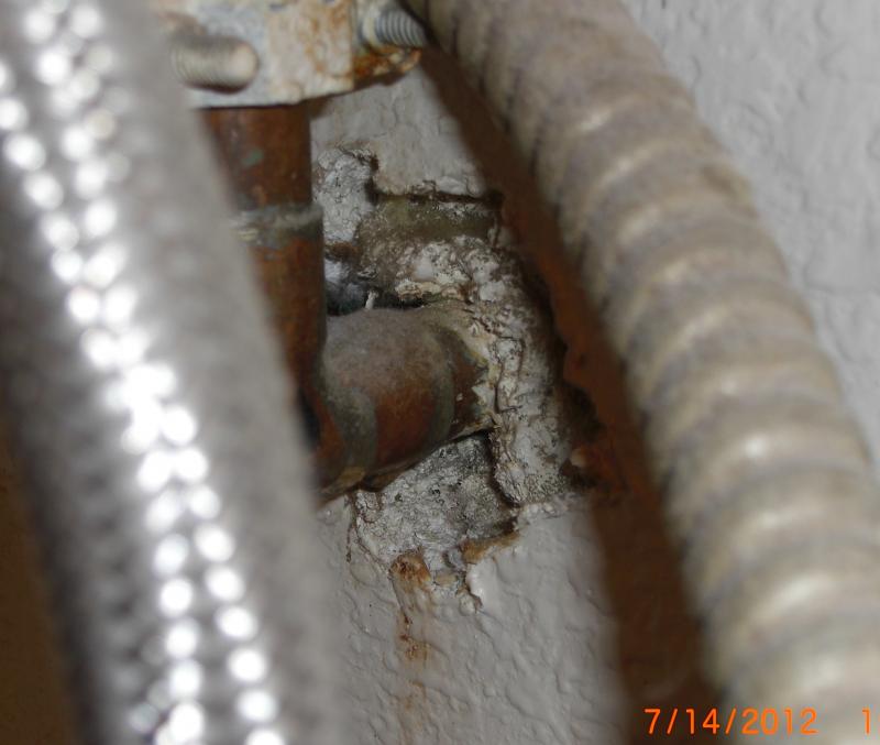

    Also:

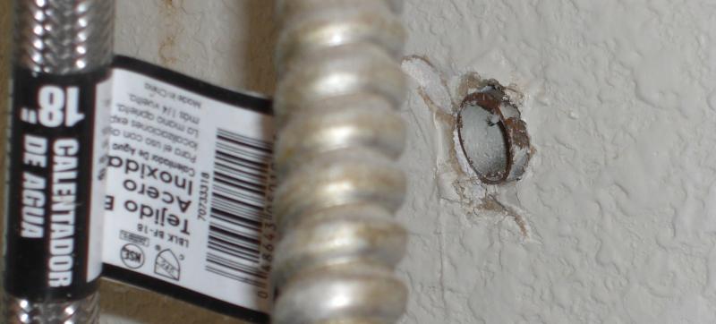

    What would be the best way/materials to keep creepy crawlies (spiders) from entering through these messes left in the wall?

    leave it alone. if it leaks, it's not your problem, it is the landlord's issue. it's probably not even a problem. I never have understood why a tenant wants to inspect and have a need to fix things they do not own... spray some raid around the penetration and call it good.

    Baking soda is used to neutralize acid corrosion on battery terminals. Rust corrosion is removed WITH an acidic cleaner, such as clr. I do not recommend messing with a water heater. Probably surface corrosion from humidity.
    electric WH can be in the bathroom; I would like to ensure the relief discharge is safe!

    That corrosion is at the anode rod which is factory installed and VERY, VERY tight so it should NOT have leaked. Therefore there may be a different problem such as tank leak which rusted itself closed after a time.
    Yakima WA
    6,838
    As HJ pointed out, the rust is on the anode rod, is not causing any kind of problem now. Leave it alone. The greenish corrosion is on the brass nipples and is quite normal. It's good advice not to mess with appliances that belong to the house. I know that getting some landlords to take notice of things is sometimes difficult, but that goes with being a renter.
