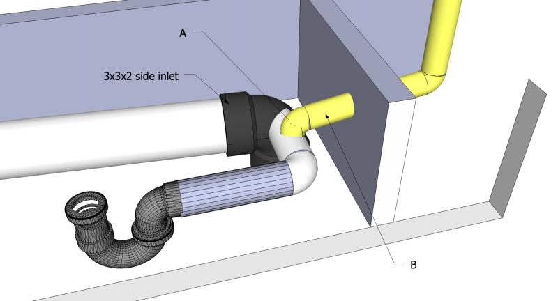

    1) Thanks to all for the input.
    2) Other option is to tie shower drain to toilet drain using a 3x3x2 low heel, or 3x3x2 side inlet. (See image below.) If I understand correctly, this complicates matters, as it will require a vent for the new shower drain (pls correct me if I am wrong). Further, the only feasible way to vent the shower drain would likely incur a downhill slope. Note that slopes are not to scale in the image.
    That said, the existing vent was formerly an LV drain and presently has no fixtures upstream from this diagram. So, worst case, backed-up shower vent would drain down the old LV drain. Still, it's ugly and likely not code. Pls comment on any other concerns over this option.
    Thanks again. Feedback is greatly appreciated.

    14,201
    You can't vent using a down hill slope.
    If the shower vent was tied into a lav waste and vent, that would work. The lav would wet vent the shower. The lav piping needs to be 2" for it to work as a vent. And it has to grade up, not down.
    The drawing above wouldn't pass anywhere.
    If you go with a 1.5" shower drain and vent, you can't wet vent it.

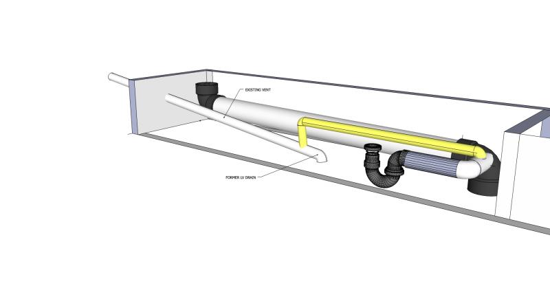

    Thanks Terry.
    from your drawing, why not keep the new vent (yellow) sloped properly and tie into old lav vent above floor, or above FLR of lav if its still to be used for lav

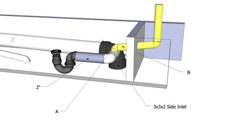

    @mikeplummer
    Exactly what I was thinking. Trick will be making all this happen between joists. Right now, am planning for yellow vent to go right instead of left, through a joist bridge, then up a wall cavity about 8" away. From there, clear run to attic.
    I will follow up with diagram.
    Renovating Footman_75's Avatar
    Jul 2012
    Ontario, Canada
    34
    ITEM A: Yellow vent drops into 2" shower drain from the top
    ITEM B: Run is 45 deg to shower drain
    Does this eliminate horizontal venting?
