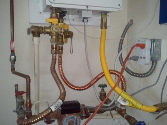

    I have a relatively large house (5000 square feet) with a natural gas powered tankless hot water heater paired with a recirc pump. We've been in the house for three years and have recently started to have some trouble with our hot water. This has led me to want to better understand the system as a first step towards diagnosing the problem we're having.
    The system:
    Takagi TK3 flash hot water heater
    Large'ish copper/brass recirc pump plumbed in to what appears to be a hot water loop

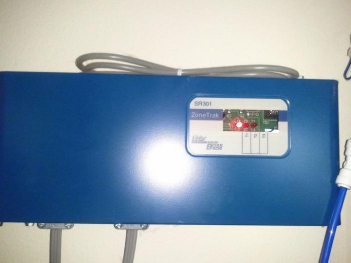

    Invensys SR301 3 zone relay which appears to be controlling the pump
    The problem:
    On occasions, when you turn on the hot water you get hot water for a while, then it goes cold for a while, then hot again and it will stay hot. This is particularly problematic in the shower scenario where you turn on the water, notice that it's hot, get half way through your shower, then get ice cold water for 3 minutes before the hot water returns.
    My Questions:
    1. What role does the 3 zone relay play when I don't have multiple zones? I assume the hot water loop is just a single zone and that there'd be a simple timer on the recirc pump rather than this big complex looking unit.
    2. I can imagine there being two different failures that might cause the behavior we're seeing. A) The recirc pump not running when it should such that there's a bunch of cold water in the lines. If that were the case though I would think we'd get cold water for a while before getting hot but once we got hot water it would stay hot. B) The hot water heater isn't kicking on quickly anymore for some reason such that we get the initial blast of hot water that was stored in the lines, then cold water as the heater is trying to cycle, and then finally hot water again once it successfully starts.
    I'm guessing it's B?
    3. If it is A, I assume I need to tweak the programming of the relay? I think it's programmable. If it's B, I assume I need to figure out why the hot water heater isn't starting quickly?
    I've read that recirc pumps and tankless hot water heaters often don't play well together and wouldn't be surprised if the builder's subcontractor did something dumb with my set-up. There have been a bunch of other things that we've discovered that are suboptimal and stemmed from going with the cheapest sub. Reading the TK3 manual seems to indicate that this particular unit will work with recirc pumps if set-up correctly.
    Sorry for the length of my post. I wanted to make sure I gave you guys all the information that might help.
    Aaron

    The controller is a pretty simple device, if it's what I think it is...it lets a 24vac thermostat/aquastat turn the 120vac power on/off to the pump...it could have a timer wired in, but in itself, all it is is a voltage changer/switch. It is normally used in a heating system. On the 3-zones, when any one zone calls for heat (or in your case recirculation), it also would turn on the boiler (and maybe your tankless system uses that input as well).

    Interesting. So it's really just a switch. That would explain why the manual doesn't mention anything about setting a temperature or time. I don't *think* the hot water heater has a timer built in but it does have a temperature setting I think. I'll re-read the manual.
    I wonder if I wouldn't be better off getting rid of the controller and just using a simple timer to control whether the pump is on or not. Basically I'd have it on for a few hours in the morning when we're likely to shower and in the evening for the same purpose.

    I would start out by removing the controller and letting the tankless operate the pump and see if the problem goes away. Why do you have a controller operating the pump?
    19,204
    There will be a pair of wires connected to the thermostat contacts in the controller...see where they go. That is what turns the pump on and off - it likely goes to an aquastat. Depending on how the tankless is setup would determine what you might do. The tankless' input could be a trigger telling it the pump is on, or it could be an output to turn the pump on (i.e., it could be using the internal aquastat as the control input to the pump's controller. Often, control voltages are 24vac, but the pump needs 120vac to run, so you can't just hook it up directly. You'd have to read and understand the manual and diagrams to sort this out.

    HJ - I don't see anything that obviously looks like a check valve or tempering valve at the heater but it's possible that there's one there and I'm just missing it? Here's a better picture... What do you think?
    https://skydrive.live.com/redir.aspx...57C7FC0206!998
    Hackney - Good question on the purpose of the relay. I'm not sure honestly. This is the way the builder installed the system. I'm sort of wondering whether the relay box is needed.
    Jim - There's a skinny wire going from the heater to the relay. You can see it in the picture above. Then a set of larger diameter wires going from the relay to the pump. The wires going to the pump are probably power wires. The skinny wire going from the heater to the relay must be telling the relay when to send power to the pump. To your earlier point, it looks like the relay is really just a big switch that gives the pump power. It appears that the heater is actually the thing deciding when to turn the recirc pump on or off.

    That could be a check valve hiding behind the wiring, if so it could still be worn out. Hold on to the return pipe while someone is using the shower to see if it stays hot or gets cold.
