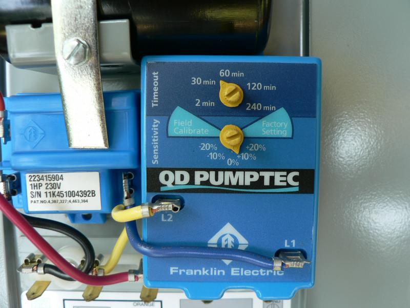

    I am using the Pumptec QD and have had very good experience with the unit. The main reason I picked the QD unit was because it easily fit inside my current control box AND had BOTH sensitivity and time out settings. The ability to adjust the sensitivity may just help you resolve your issue. As you are well aware, the present unit that you are using does not allow you to adjust sensitivity. I would contact the folks at Franklin Electric, explain your situation and see if they think the QD model will help resolve your concern.
    Franklin Electric Technical Assistance: 1-800-348-2420

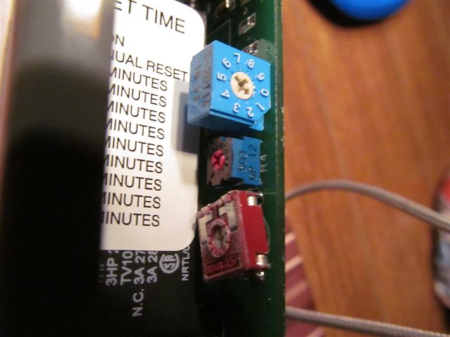

    I have just had the motor replaced, I guess there is a chance that this motor will trip the pumptec when needed however initially i didnt think I had sensitivity calibration but it looks like I may have -although hard to get at. Would you know if and which of the 2 lower dials are for the sensitivity-the top one is obviously the re set timer dial.
    thanksName:  pumptec2.JPG

    A while back when I spoke with technical support about their different Pumptec models, it was my understanding the Pumptec did not have a sensitivity setting as did the QD Pumptec. I guess I could have misunderstood what was stated or the older models such as yours did offer this functionality????
    It may be in your best interest to give Franklin Electric a call to see what the two additional pots are used for. I really don't think the two pots shown in the photo were meant to be adjusted by the end user .................. but, I could be wrong. I would like to think that if the pots were to be adjusted by the end user, there would be some kind of information readily available such as the reset time documentation shown in your photo.

    thanks TVL I will give them a call but I am guessing that they will say "no serviceable parts etc" and suggest another model-I was just hoping someone may know as although it may not be intended for the end user to adjust-it would seem to make sense that there is an adjustment somewhere in it.
    I may end up just trial and error adjusting it

    Quote Originally Posted by warrens View Post
    Looks like the bottom Red Pot may have let some of its smoke out.

    I am pretty sure it is all functioning correctly since i have a second well system and when I swap pumptecs around they each work on one but not the other

    See I told you there where adjustments on the inside. However, I don’t know which is which. No matter how much “advice” you get, it is still a trial and error adjustment. This is unlike the Cycle Sensor, which has a digital display to show you exactly what the pump is doing and exactly where the low amp setting is. BTW, too small of wire causes low voltage and “high” amperage, which could have caused the heat that “let the smoke out of that bottom pot”.
