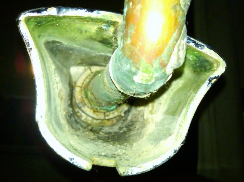

    Need to remove my tub spout (for new surround). Tried turning it counterclockwise to unthread it but it didn't budge. Do I need to use a strap wrench, perhaps, or could there be a locking screw hidden that needs to be loosened first? Faucet assembly is Delta or Moen. Thanks, guys!

    Thanks again, guys! I found 'Moen' stamped on the valve escutcheon and I was able to force it the spout to turn with a strap wrench (since I saw no set screw). BUT, the spout STILL won't come off. (I'm turning it counter-clockwise as I stand inside the tub). Did I miss a set screw somewhere? Thank you so much for any suggestions! Anxiously waiting! (I'll post a photo I took, if you think it would be helpful, as soon as I find the cable for my Blackberry.)

    Hi Terry, It looks like it threaded to me. Do you see the hex fitting in the photo taken from inside the wall below? The spout turns (strangely, both clockwise or counter-clockwise), however, it won't come off (or unthread if it is indeed threaded as I think it is).

    That looks like a threaded Moen #3811 diverter spout. Turn the spout and see if the copper tubing rotates with it.

    HJ, I did just that. And, yes, I think it's threaded because you can see a hex copper (or brass) fitting in the photo (above) very near the outlet of the spout (near the diverter assembly). I had one of my sons turn the spout while I watched from the hallway (from the same location as the photo above) and, no, the copper didn't rotate. What DID rotate is the spout (obviously) but also the white plastic fitting (fluted, I think--look closely at the photo) that you can just barely make out (part of the diverter assembly, I think), at the farthest point from the camera, right near the outlet of the spout. If you look closely at the photo you can see what looks like 4-5 tiny radial cracks (maybe 1/8" long) in the fluted (white plastic) fitting, spaced anywhere from 1/4" to 3/8" from one another. When the spout is turned, the fluted (white plastic) fitting slips over a mating fluted surface (presumably brass). In other words, I probably stripped the plastic flutes off when I turned the spout with the strap wrench (or they slipped because of the radial cracking which, again, I may have caused when I turned the spout with the strap wrench).

    Anyhow, still wondering if I should attempt to pull the spout straight out (and off) or should I sweat the solder joint at the first copper elbow. I can't think of anything else to remove it other than cutting the 1/2" copper pipe right after the elbow, just before the pipe starts the 4"-5" run inside the spout.

    If you have access to the copper pipe, cut it.
    Then you can throw away the old tub spout and install a new one. You will need to install new pipe, the parts aren't much, and soldering 1/2" copper is pretty simple.

    Heat the end of the spout. The plastic insert will melt and you can pull the spout off of it, then clean the adapter and screw a new spout on, if you can find one with the same dimension so you do not have to cut or extend the copper.
