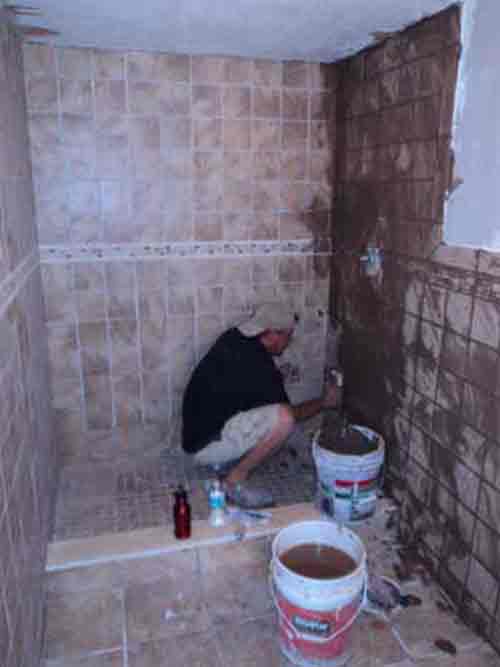

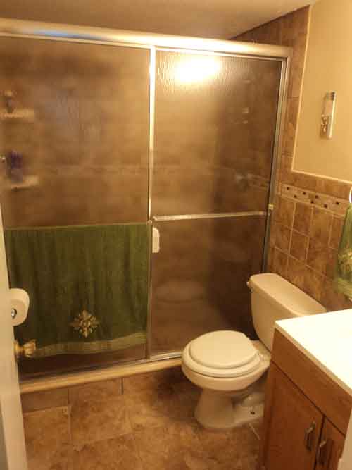

Size:  15.7 KBI have been a Handyman in Orlando Fl for over 20 years and Personally I would not use drywall or plywood I would use wonder board or some people call it cement board. Over time drywall tends to deteriorate because of the prolonged exposure to humidity and water. I have seen shower walls done with drywall that literally come crumbling down. Don't use drywall, at least not in the Shower area. as for the walls you can use 2by3 or 2by4 to frame it the way you want it and just tile over the wonder board. Hope this helps
