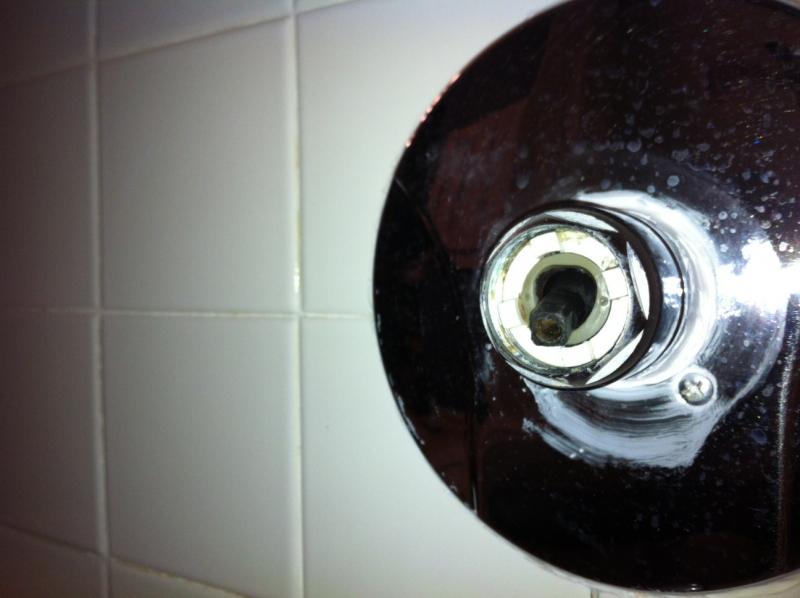

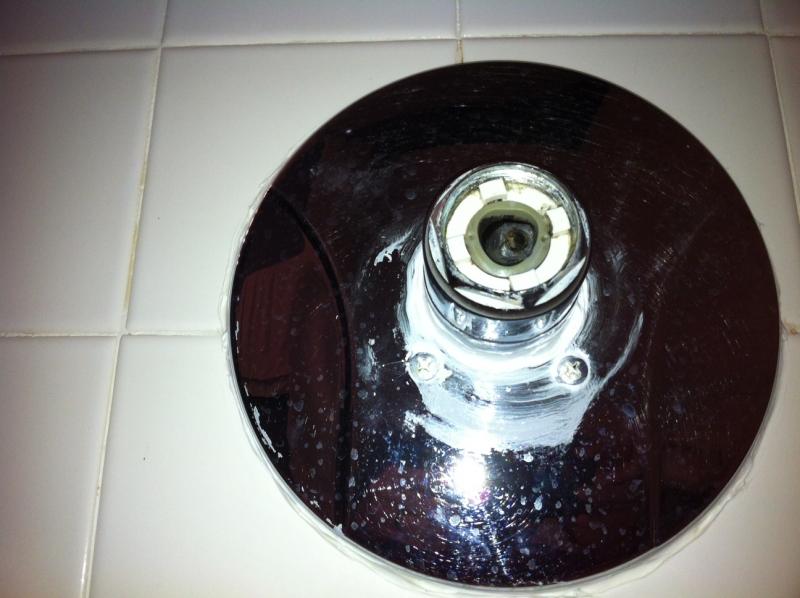

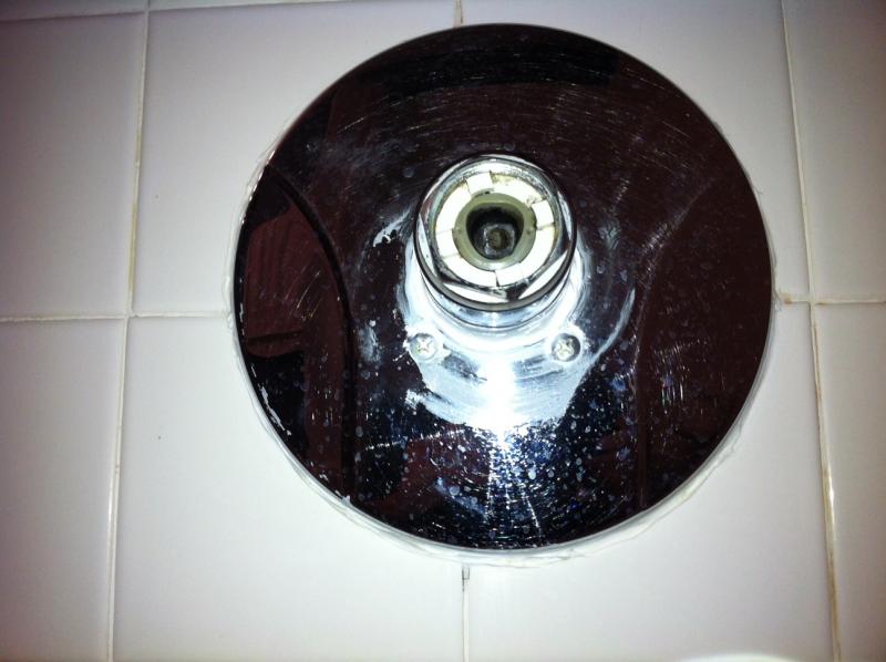

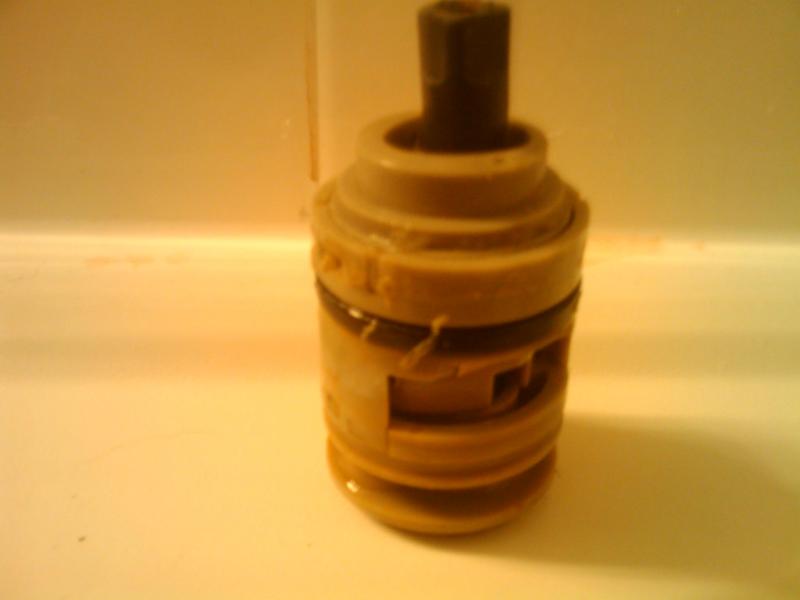

    Hello,
    I was hoping someone might be able to help identify the make of this faucet so I can replace the handle. The prior owners replaced it with what I believe is a sink faucet round plastic handle which cracked at the top due to not being able to clear the fixture. The stem goes up and down then left to right for hot/cold. The fixture sticks out 1 7/8" if that helps. Please ignore my horrible caulk job.

    Sorry - I got nothing. Maybe your missing a collar and a handle. I got nothing for you sorry, doesn't look like any trim I've worked with.

    If it might help identifying the handle and possibly missing collar, I noticed that the stem will spin causing the temperature to change. I'm not able to push/pull the stem to turn the water flow off/on. The on/off is controlled by an up/down motion. I had thought earlier that temperature was only controlled by the left/right movement.
    Not sure if this helps, but thought I'd include it in a last ditch effort.
    23,560

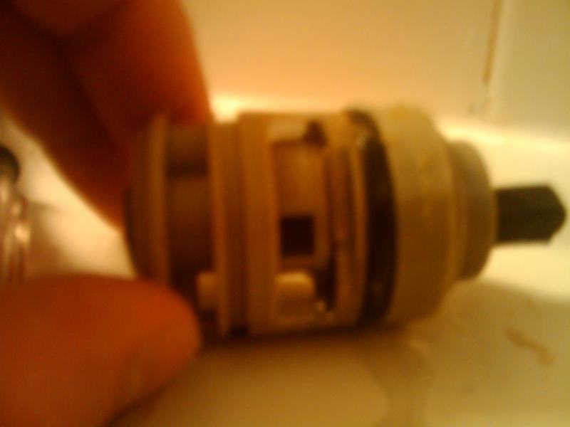

    WE would need a picture of the cartridge itself to try to make a determination. What we can see is "similar" to several brands with some variations. Seeing the cartridge, especially the bottom of it is crucial, especially if we cannot see the handle itself.

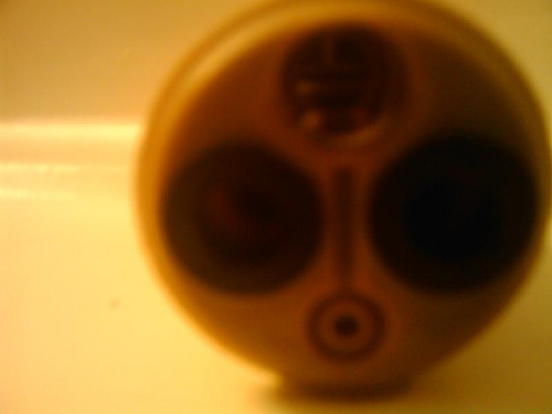

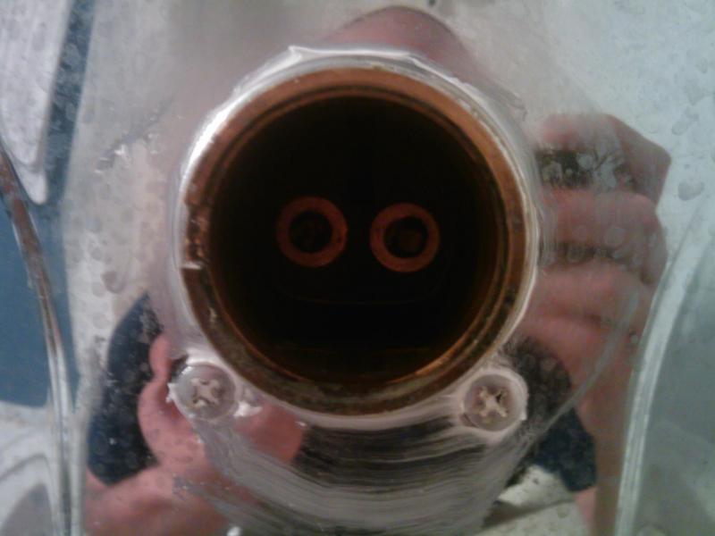

    Sorry these pics are so blurry, if these are of no help, I'll post more with a better camera. The first 3 are of the cartridge itself, I tried to get a couple angles not knowing if this would help. The last is inside the faucet, there is a notch taken out on the left that matches with the cartridge.

    Think I might have identified the cartridge make from: http://www.alfanoplumbingparts.com/p...ridgesPtoZ.pdf
    I believe it's the Valley VAL7002, at least the measurements match and looks identical. The problem I have now is not knowing where to look for the replacement handle. From what I've read, Valley has gone out of business. Any sites anyone knows of that I can search? Thanks.
