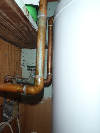

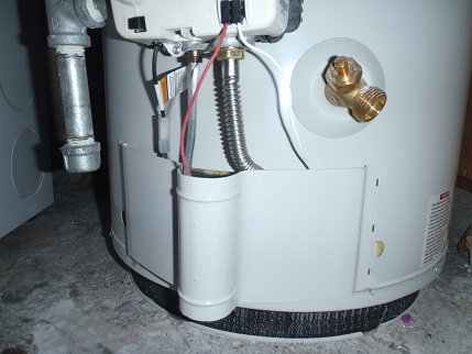

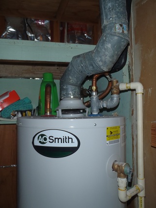

Please post the brand name, model number, and s/n and any pictures showing the bottom of heater with gas valve, and the top of the heater with the plumbing connections,

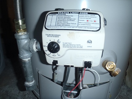

Yes, the thermostat is set to "very hot" (see picture).
The hot water heater is turning off, so it isn't running all the time.

I took a bunch of pictures. I do have a contractor working on my bathroom. My husband talked to him today and he said he did turn off the hot water when he was taking out the tub and then turned it back on. Would that have caused the pilot light to go out and all this to happen? Or if it is leaking in the wall would it cause it to not get super hot? The gas guy said I probably have something in the wall that regulates the temperature so if I try to turn on super hot water it adds cold into it? It didn't use to do that, it would hurt if I had the water too hot.
ps - that side picture is the knob that the contractor turned off and then back on. I still don't think that would have caused the pilot light to go out, but I really don't know?

Gas Valve limit setting
Hi cacher_chick - nope it is all the sinks in the house, bathroom and kitchen.
I think I would try to set the Water temperature back to normal "Hot" and test it there.
It may have a stupid sensor if you turn the Gas valve all the way up.

I looked up that model and the gas valve may not go as high as you have it set, and the heater may be shutting down on thermal limit.
The LED should tell you what it is doing.

Thanks! I will definitely give it a try tonight. The LED blinking light says normal operation, so hopefully that is the problem and I just set it too high. I am imagining a broken pipe in the wall leaking out all my hot water (can't even imagine how much that would cost to fix)!
