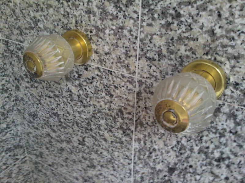

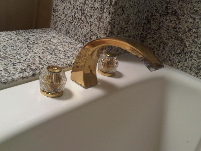

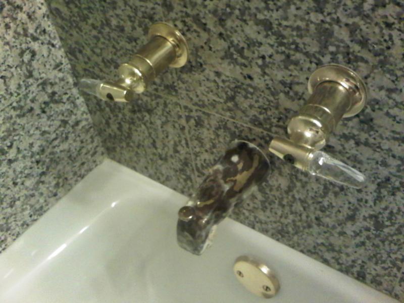

    I would like to replace these shower and bath faucets without cutting into the walls if possible. These are American Standard faucets and are about 20 y/o. American Standard no longer makes parts for them. I am hoping that someone makes replacements parts for them or a similar product that I can replace them with without cutting into the granite. There is no "access panel" for them. To clarify, I have one shower, one roman tub, one shower tub combo.
    Faucets are from the American Standard Elger line. These are the model numbers:
    Shower with acrylic knobs is TC934
    Roman Tub is TH936
    Shower with spout is Y24849-04
    I appreciate all your help.

    That bottom valve looks like a Delta or Valley, but we would need to see the stems under the handle to be certain.
