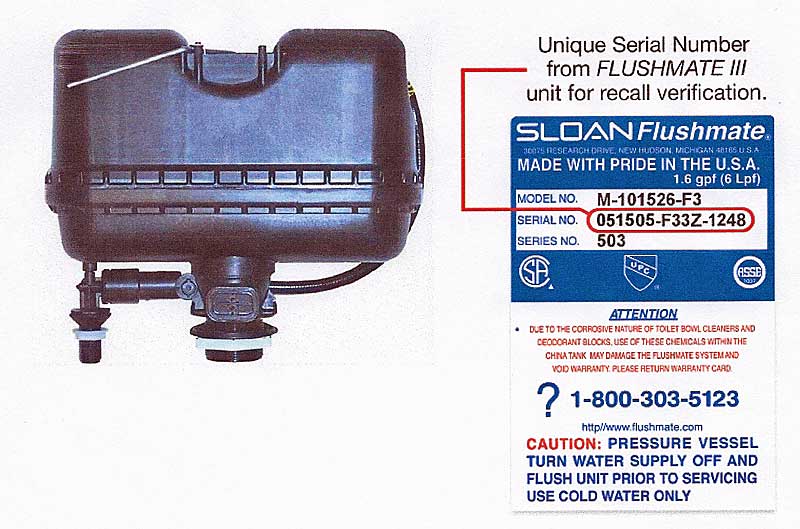

    Description: This recall is for Series 503 FlushmateŽ III Pressure Assist flushing systems
    installed inside toilet tanks. The recalled systems were manufactured from October 1997 to
    February 2008. The units are rectangular, black, two-piece vessels made of injection molded
    plastic. The date code/serial number is 16 characters long and is located on the label on the top
    of the Flushmate III. The first six numerals of the serial number are the date code. The date code
    range for this recall begins with 101497 (October 14, 1997) and continues through 063009
    (June 30, 2009).

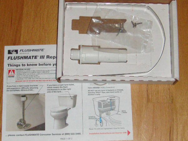

    I figured that they would try to resolve the safety problem while keeping costs down, so I was expecting them to send the equivalent of a large hose clamp or two and use the hose clamps to keep the two halves intact should the pressure vessel rupture.
    Well that is pretty close to what was sent. They sent a U-band and a pressure regulator. I guess the vessel ruptures due to high water pressure. I guess as long as it does not launch the porcelain lid in the air the safety problem is resolved.
    Here is the kit that was sent:

    The instructions: http://www.carlhaines.com/junk/fmRepair.pdf
    Also, there is an instructional video: http://www.flushmate.com/recall/video/
    I do wonder about how much water may leak when the vessel ruptures. Will it drain from the tank to the bowl fast enough to prevent it the tank from overflowing or is there the potential for a flooding problem? Is the water still contained when this happens? It is probably good insurance to turn off the water supply to the toilet if you are going to be away for an extended period of time.
    I have a Cadet 3 Pressure Assist that I pulled from the bathroom on our main floor and was planning to reinstall in our basement whenever we get around to finishing the basement. After seeing the pictures and videos, I'm not sure I want to keep this toilet and that is after installing the "repair kit." Also, I don't like that external regulator. It is ugly and if I had one of these in a commercial establishment, I would be worried about somebody kicking it and breaking it either accidentally or on purpose.
    14,201
    I believe that the newer tanks have the built-in pressure regulator. That would account for the 2008 and before recall. During a class that I was taking, it was mentioned about the reducer for the water pressure. I was wondering if the fix-it kit was going to include the reducer, and I see it does. Adding the U-Band is a nice touch.
