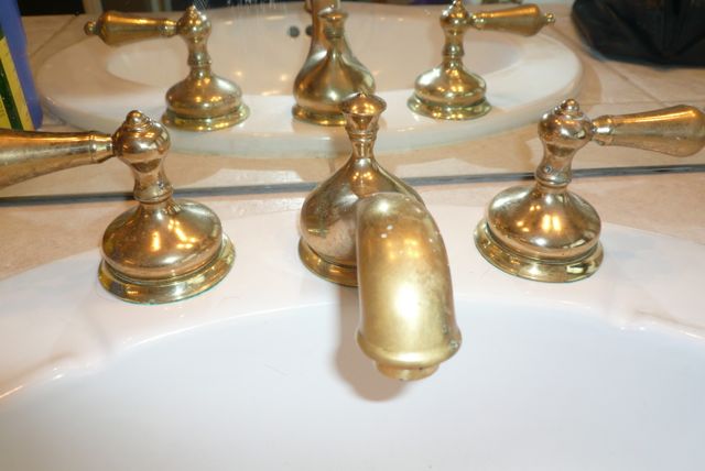

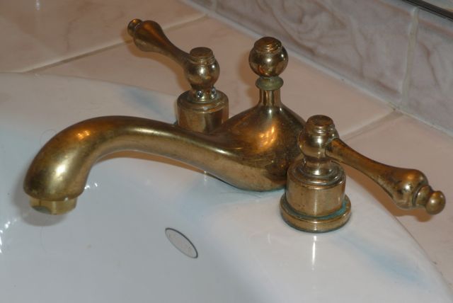

    See photos of mini widespread and 8 inch widespread faucets. Any help identifying the manufacturer would be greatly appreciated!
    25,655
    Those designs are almost generic with the various "custom" manufacturers. They could be California Brass, Artistic Brass, or any of a dozen other brands, many of them out of business. A photo of the stem will often identify who made the basic unit, but not always who added the artistic design to it.

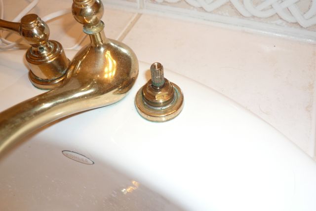

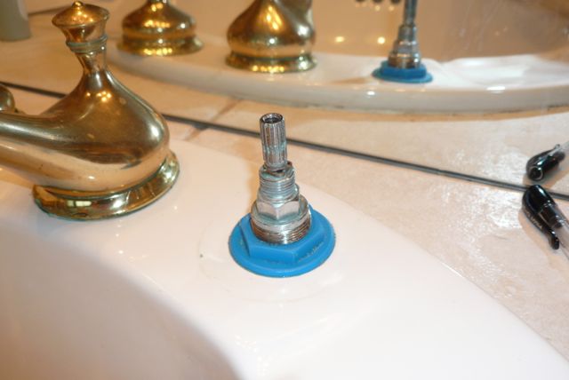

    See attached photos of faucet stems. Any idea who made the basic unit?
    Plumber jimbo's Avatar
    9,001
    In the lower photo, the spout reminds me of American Standard Jasmine, but I don't think the handles are right for that. The cartridge could be AS, similar to 994053-0070A

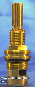

    After months of research, I may have found the manufacturer of the widespread stems... Brasstech Faucet Part (FLU-4685 and 4686). My question is whether I can replace faucets with a trim kit made by Brass Tech?
    9,001
    Brasstech is not a faucet brand per se, it is a conglomerate. http://www.brasstech.com/ Your faucet is a dated design, and the availabilty of trim is doubtful.
