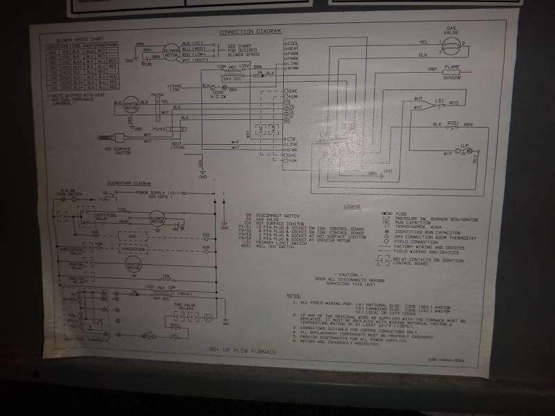

Somewhere inside the furnace, possibly on the back of one of the covers, you might find the wiring diagram for the furnace. That will help.

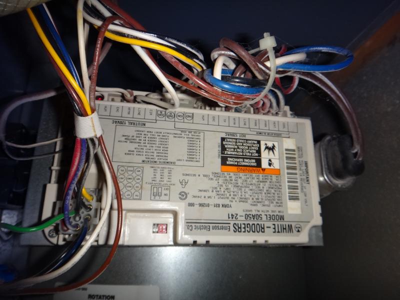

I can't see "G" terminal in the furnace. Any idea by looking at the pics?
I have a w-r model 50a50-241 control for my furnace. Where would i attach a wire for low speed or high speed? Would it be on cool, heat, park , or park?

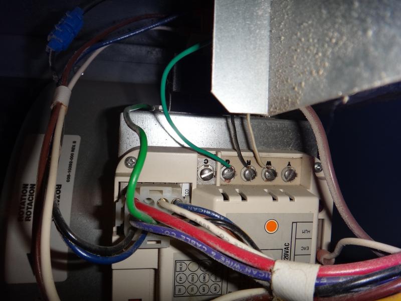

Ok I found the G terminal.
I attached green cable to G terminal in the furnace, and the other end to G terminal on the thermostat
Here is the pic. Still nothing though. My thermostat says that it is working on cool, but the fan does not turn on in the furnace. I tried on and auto option.
Any insight?

I think that the red wire should be connected to R. Why the black was used instead of red seems incorrect.
The black may be in the wrong place on the thermostat. That would depend where it connects to the thermostat, and the type of thermostat.
The thermostat may need a Return connected to C. (another wire if it requires power)
May be time to get the voltmeter out, and look at the thermostat manual.
Sounds like it may have On/Auto Fan switch. If not No Go.
With nothing connected to Y, Then the thermostat should not have a Cool mode.
Is this unit connected to a Air Conditioner also ?

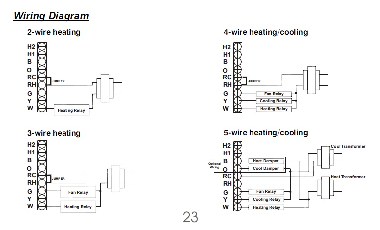

The model of thermostat is noma 303M
here is the pic for the wiring:
I had only 2 wires attached (as in 2 wire diagram) black into RH and white into W
I added green wire to G both in the furnace and in the thermostat.
I have no AC
I tried to run the fan on heat (it works with the heat but not without)
I tried to run on cool (auto and on option) Thermostat kicks in and it shows that it is cooling, but fan in the furnace does not kick in
Would I need another wire for Y to make it work?
Thanks

Do you have the jumpers between the RC and RH as shown in the 3-wire heating diagram?
When the fan switch is in auto, the furnace or a/c generally control the fan, an only indirectly from the thermostat. On heating, it turns on when the air by the heat exchanger gets warm (on many, but not all). On a/c, it often turns the fan on immediately when it calls for cooling. So, if you tried to fool the furnace into thinking it has an a/c unit attached, and you wanted the thermostat to control the fan being on/off, instead of the G terminal, move it to the Y terminal on both ends, and make sure that the thermostat is in the cooling mode. But, if it is wired per the 3-wire heating diagram (with the jumper), putting the fan switch to ON should turn the fan on ANY time the furnace is powered up. The G wire is an override from the furnace's normal control of the blower. When in AUTO mode, the lead is not used, the blower control is all within the furnace based on the thermostat calling for heat/cold, and other internal conditions.
