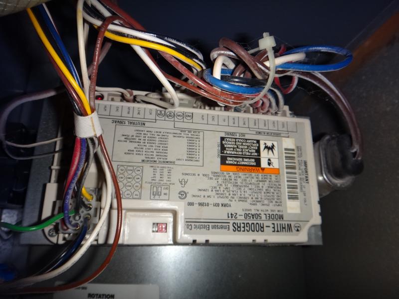

Size:  49.5 KBName:  DSC00141.jpg
    I can't see "G" terminal in the furnace. Any idea by looking at the pics?
    I have a w-r model 50a50-241 control for my furnace. Where would i attach a wire for low speed or high speed? Would it be on cool, heat, park , or park?
    Thanks

    Ok I found the G terminal.
    I attached green cable to G terminal in the furnace, and the other end to G terminal on the thermostat
    Here is the pic. Still nothing though. My thermostat says that it is working on cool, but the fan does not turn on in the furnace. I tried on and auto option.
    Any insight?
    Mar 2011
    Houston, TX
    3,632
    What is the make and model of your thermostat ?
    Plumber jimbo's Avatar
    9,001
    Does your T-stat have a fan switch...labeled ON-OFF-AUTO ??
    Mar 2011
    Houston, TX
    3,632
    I think that the red wire should be connected to R. Why the black was used instead of red seems incorrect.
    The black may be in the wrong place on the thermostat. That would depend where it connects to the thermostat, and the type of thermostat.
    The thermostat may need a Return connected to C. (another wire if it requires power)
    May be time to get the voltmeter out, and look at the thermostat manual.
    Sounds like it may have On/Auto Fan switch. If not No Go.
    With nothing connected to Y, Then the thermostat should not have a Cool mode.
    Is this unit connected to a Air Conditioner also ?

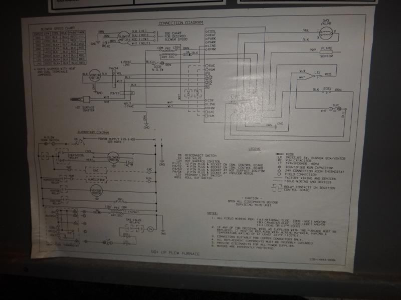

    Thanks for all replies.
    The model of thermostat is noma 303M
    here is the pic for the wiring:
    I had only 2 wires attached (as in 2 wire diagram) black into RH and white into W
    I added green wire to G both in the furnace and in the thermostat.
    I have no AC
    I tried to run the fan on heat (it works with the heat but not without)
    I tried to run on cool (auto and on option) Thermostat kicks in and it shows that it is cooling, but fan in the furnace does not kick in
    Would I need another wire for Y to make it work?
    Thanks
    Mar 2011
    Houston, TX
    3,632
    Seems that you could run it on heat and put the temp very low. (So heat is not called for)
    Would that make the fan run ?
    I don't think a connection to Y will help.
    Just connect it for the number of wires you are using.
    3 should work.
    DIY Junior Member PistolPete76's Avatar
    Jun 2012
    Ontario
    12
    I tried that with auto setting, and that didn't work. It only moved the fan when i cranked the heat up (higher than room temp) I never tried with ON all the time (at least that i can remember as i was switching it back and forth). I'll give that a try, though it would be nice to have it to kick in in auto mode, but i'll take what i can get.
    Will let you know tonight
