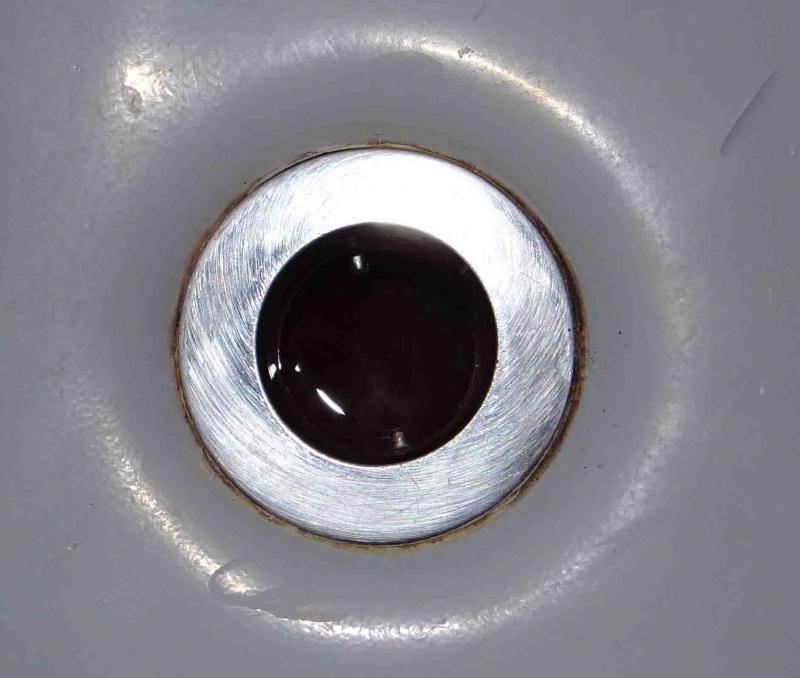

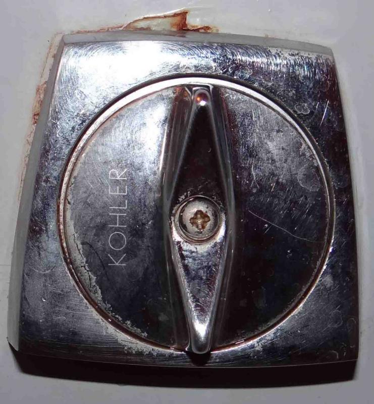

    I took a couple of pics to see if anyone can identify the drain manufacturer (the overflow cover says Kohler?) The drain itself has 2 little ears that could be used to turn out the drain, however a standard drain removal tool is way too small on one end and slightly too large on the other end.Name:  drain1.jpg

    12,599
    A dumbbell tub tool works on those Kohler drains.
    23,715
    When the overflow plate says KOHLER, it is a Kohler drain assembly. There are several tools specifically for removing the drain plug, but NONE of them are inexpensive enough to warrant buying to remove a single drain fitting, especially if they do not work and you have to cut it out anyway. One thing NOT to do is try to force it, because you could break the tube under the tub and then you DO have to replace the entire drain.
