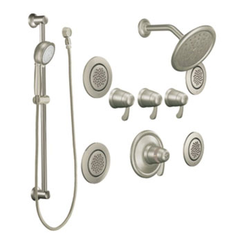

House has 1/2 supply lines.
Custom Shower Design
MOEN TS276BN
MOEN TS3400BN
Her Shower::eek:
1 Moen Exactemp Shower Valves at 3/4" (2.5gpm at max) S3600
4 Moen Body Sprays new version at 1/2" piping (ea at 2.0gpm at max) Model TS1322
1 Moen Handshower
His Shower:mad:
1 Moen Exactemp Shower Valve at 3/4" (2.5 gpm at max)
Shower and Body sprays have independent volume controls.
Max demand her shower with everything on blast: showerhead and 4 valves = 10.5 gpm
Frequent use: Just dual showerheads at 5.0gpm

There is no 1/2" except for the body sprays and they would be fed off the flow of the 3/4" run to the independent volume control.
The length fo the run is disclosed at 120'
The question is will running 3/4" CPVC (minus friction/fitting resistance negate any benefits of going up in size)
Would I be better off doing what the plumber suggested and just tying into an additional cold water near the bathroom for pressure?
The hot will need 3/4" from the water heater. The cold should also be a combined 3/4"
