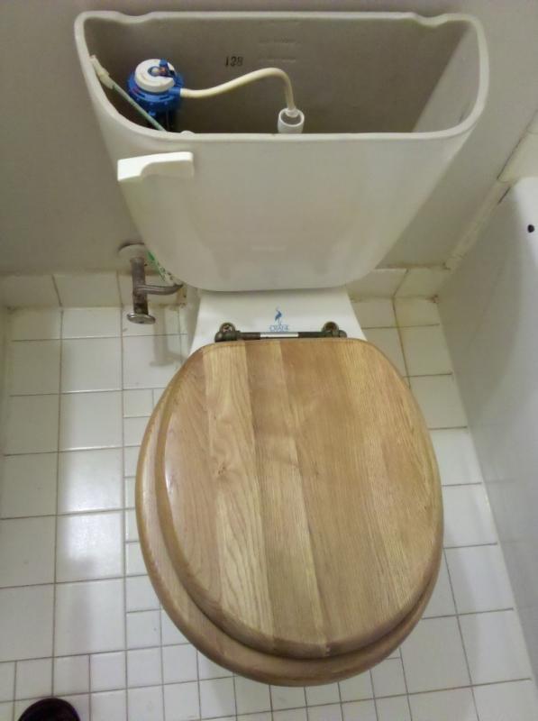

    I'm told by the building management that this is a rear discharge but looking at the back it doesn't seem so. Name:  1a.jpg

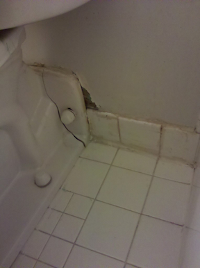

    Additional photo. Name:  2a.jpg

    That's a floor mount, rear discharge bowl.
    American Standard Yorkville
    Kohler Barrington
    Also Caroma makes one.
    The drain is 4-1/4" above the floor. It takes either a special reinforced wax ring intended for wall mounting, or a neoprene rubber seal.
    And next time peal off the paper label on the water supply.

    Interesting. It looks like the turn back would be too sharp to be rear discharge. But I'll take your word for it.
    Also any hunches about why it broke?

    A standard toilet discharges down to a toilet flange about 12" from the wall...there's no way that toilet directs the discharge there!

    I am guessing that it is broke because it was leaking and someone over-tightened it to get the leak to stop, and just made it worse.

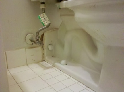

    Thanks guys. Here are some more details. We just bought this reo condo and I knew we had some fixing up to do but didn't realize what the toilet was or how bad it was. We usually do our own handyman work including plumbing so I didn't think much of it. But plumbing isn't my strongest suit, that's more my dad's bag. Once he had a look at it he said he's seen these rear exit toilets before but wasn't sure that this actually was one. The association maintenance department seems to be willing to install the toilet if I can get one. I'm not sure why they don't have a vendor to recommend seeing as there must have been quite a few of these in the building (almost 300 units) but I'll get some more info next week. I came here trying to figure out what it is I'm looking for. Here's another photo of this beautiful piece of machinery. Name:  3.jpg

    The cracked plaster at the wall needs to be looked into when you take that off. May be water damage, ( possible leaking wax ring), or possible movement of the flange in the wall.

    The sharp turn would indicate that this toilet uses the same "pattern" as a floor discharge and then it is modified to add the rear flange and turn the outlet to the rear. I makes a poor waterway to have that abrupt turn in it. Normally, if there is one toilet like that in a complex, then they are ALL like that, not just "quite a few".
