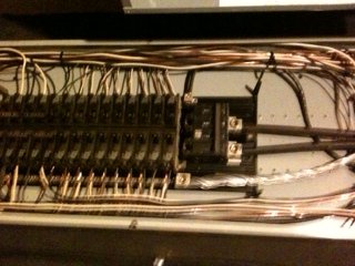

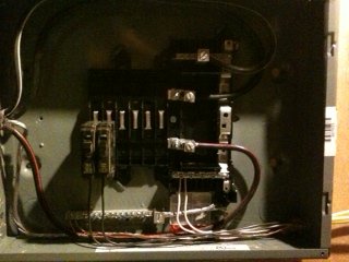

    I've added a 100 amp Sq D subpanel off of a Seimens 200 amp service. The cable I used has 4 wires (1 black - hot, 1 red & black - hot, 1 black & white - neutrel and a ground). My question is where these wires go into the 200 amp service. I'm assuming the following:
    1) The 2 hots get connected to the 100 amp breaker in the main panel.
    2) The black & white gets connected to the left side of the panel on the neutral side
    3) The ground gets connected to the ground bar on the right side
    *** I've attached pics of both the sub and main panels***

    Your description sounds correct. The photos do absolutely nothing to clarify the description.

    remember to keep neutral wires on the neutral bar, and keep grounds on the ground bar. they need to be separated in the subpanel. you should also 'recode' that neutral wire with white tape, like they did in your main panel, just so everyone who may look at that panel knows that it is neutral.

    He is assuming that your wires are #4, although I have not seen anything to indicate that that is the case. In fact, although we have nothing to compare sizes with, the wires in the right hand panel do NOT seem to be thich enough for #4. Aluminum wire has less capacity than copper wires of the same gauge . Three wires in a "cable" also have reduced capacity compared to single wires in "open air".
