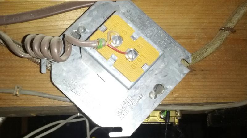

    Hello,
    As far as I can remember, this piece has been the cause of a humming noise. Any ideas on what this does and if I could easily replace it?
    GregoryName:  IMG_20120529_211511.jpg
    Plumber jimbo's Avatar
    9,001
    It is the transformer for the low voltage controls. Need to find the specs, might be printed on the other side somewhere. Most likely, it is 24 VAC output rated 40 volt/amps. Any electric supply or heating supplier will have it. Do not subsitute a "doorbell " transformer from the hardware store.
    Electrician ActionDave's Avatar
    Feb 2009
    Colorado
    326
    All transformers make that humming noise. A new one is not guaranteed to be any quieter.
    Mar 2011
    Houston, TX
    3,637
    Quote Originally Posted by ActionDave View Post
    Especial when mounted on a plate like that.
    Normal operation for the way it is installed, I think.
