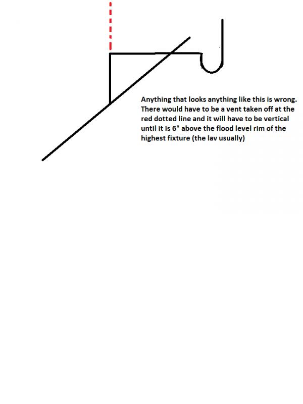

    Nov 2010
    Maine
    2,946

    To answer the question headlining your post, S-traps are strictly prohibited in U.S. plumbing codes.

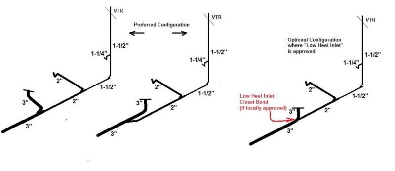

    Here's a picture. I'm venting the bathroom from the end with a wet vent. FWIW there is also an existing vent downstream from the toilet.
    The fixture arm for the shower is my PROBLEM because of the space available. Since the vent is at the end I do NOT need and cannot work in
    a separate vent for the shower. So this leaves me trying to get a "P" trap in with only six inches left before I am directly over the 3 inch horizontal branch line
    (which is below the sub-floor about 12 inches) . So as I see it I have two options available to connect to the 3 inch line.
    1) Bring the the "P" trap end into a San-Tee which will give me a vertical drop to the 3 inch Y Combo and Cap the top of the 2 inch San-Tee since there is NO VENT.
    2) Bring the "P" trap end into a 45 and then drop to my 3 inch line.
    Personally I don't see the difference in one or two (both make the connection).
    Any feedback on (1) or (2) with advantages / disadvantages explained would be appreciated.
    Any alternative also appreciated.

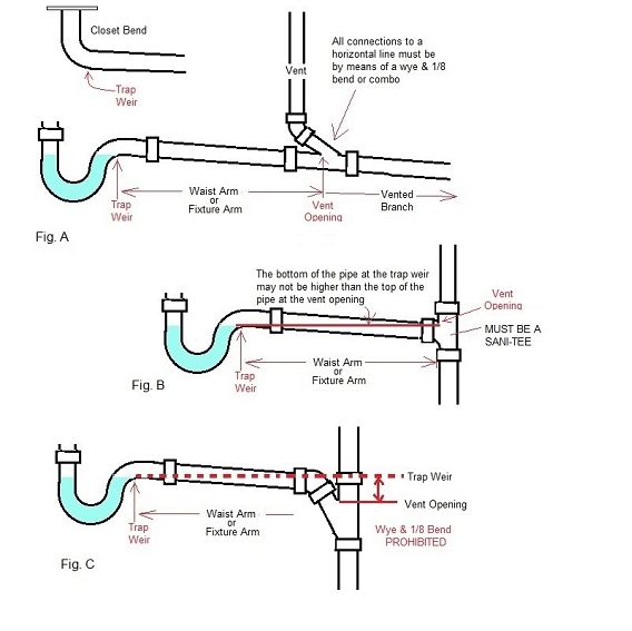

    Here's a good diagram re: "P" Trap slope issue:
    On the above example, I disagree with the maker of the drawing that a San-Tee can NOT be used in a horizontal. From my reading it can be used on the
    horizontal for a VENT PIPE ONLY -- however, it can NOT be used as a drain. So in the top picture, the Y Combo could be a San-Tee since it just services a vent.
    However, if this was a wet vent then it would NOT be acceptable.

    We still cannot see what YOU have to work with. From what you are describing, the solution might be to make the connection further downstream instead of so close to the shower drain.
    The drawings above fail under code, as they show a 1-1/2" wet vent, which is not allowed.
    The sanitee on the horizontal is strictly prohibited except on a DRY vent connection to a horizontal vent (above the flood rim of the highest fixture served). A wye or combo is the only proper fitting for a vent take-off on a horizontal drain.

    Let it be known that NONE of these are my drawings. Just some examples I found to help describe the situation.
    cacher_chick
    FWIW I'm using a 2 inch wet and dry vent and where it shows 1 1/2 I'm also using a 2 inch.
    The san-tee on the horizontal is strictly prohibited except on a DRY vent connection to a horizontal vent (above the flood rim of the highest fixture served). A wye or combo is the only proper fitting for a vent take-off on a horizontal drain.
    Will double check SAN-TEE can NOT be used for a dry vent on the horizontal.
    Logically -- to me -- this doesn't make sense since whether you use a Y combo to vent vertically from the horizontal or a SAN-TEE,
    both are only carrying air.
    Add: Look at the bottom Note which supports SAN-TEE use for venting. https://ibcode.com/uploads/Aug_24_Sanitary_Tee.pdf
    The bottom pictures show waste into SAN-TEE and I agree NOT TO CODE.
