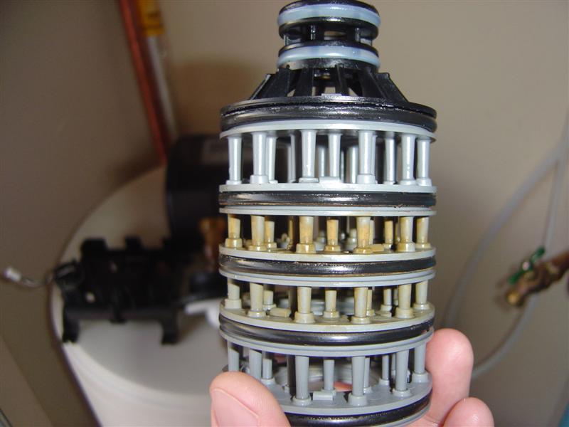

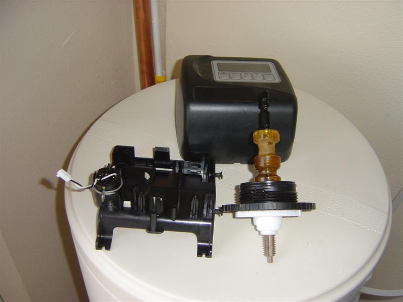

    Fact is that Teflon coating usually doesn't fail unless it is scratched. Most of Fleck's pistons are Teflon coated. The seals fail to seal on the piston(s) when they are scratched or torn by the scratches in the Teflon. OR, from a build up of something in the water that builds up in between the spacers between each seal, that prevents the seal from running on a smooth piston surface.
    Now I don't know but from what you've said here in numerous threads, you are a first time softener owner for like a month... my guess is that you have never seen a piston or seals or spacers in a Fleck or the stack and non Teflon coated piston in a Clack, or, the flapper valves in an Autotrol valve. I have 25 years of seeing them and replacing them. BTW, the seals are not 0-rings.
    So you are working on a theory, and I'm working from actual field experience and as Yogi Bear used to say, “In theory there is no difference between theory and practice. In practice there is.”.
    So you hang on to your theory and I'll speak from my first hand experience, especially the part about too infrequent regenerating, especially in this case with iron in the water, and my seeing a fair amount of build up on spacers and pistons and readers can decide for themselves as to which way they view the future serviceability of their control valve.
    Here are pics of a Clack pistons (there is a black brine piston on the far end of the main piston) and seal stack. Note the rust build up on one of the spacers? The stack/pistons were only a few months old and was allowing an internal leak in the valve. A new complete piston and stack cured the problem.
    I have pics of a hard whitish biuld up on the main piston and spacers and a torn seal but I can't find it just now and knowing yous guys, I'd probably be accused of doctoring anyway, so these are all ya git.

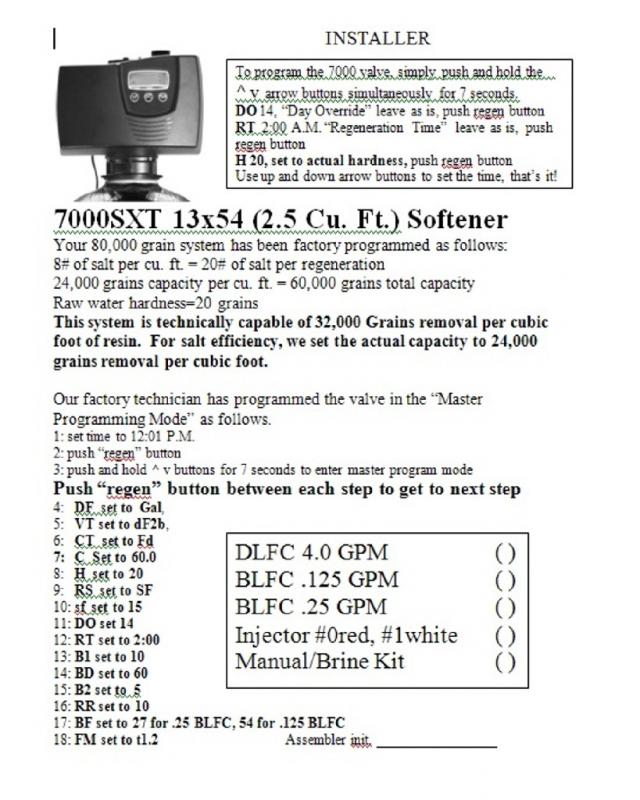

    Salt dose is set by the brine refill time. In the master programming the refill time can be adjusted. See the programming guide below that we ship out with our equipment. You will need to determine what BLFC you have, it will be on a small white sticke on the back of the valve.
    14 days is the over ride. Should you leave for vacation, or if your water usage causes the system to regenerate infrequently, the system will regenerate on the 14th day and will reset the meter count. If you are using your system for Iron removal, the system should be regenerated at least every2 weeks, if you are not using it for iron removal, you can easily go 30 days between regenerations.
    Brine tank salt level, keep it full. Try to not let the salt level fall below the water level. if it does, it will not hurt anything. As long as their is undissolved salt in the brine tank.
    Water level in the brine tank... it depends on the BF setting, and if the valve is programmed for Brine Fill First or Standard. I recommend standard unless you are use Potassium Chloride.
    If you did a master reset, you will need to fully reprogram the valve, use the guide below to do this. Most companies pre-program the valve to the system size before shipping, all you are supposed to do is set the hardness, and time of day, the rest will be taken care of by the valve.

    Thanks for the replies. After crunching the numbers, I am at roughly 41000 - 51000 per regeneration at 8-10 days respectively. This means that I fall between 6 and 8 lbs/cuft. for the most efficient salt dose. Can a 7 lbs dose be done? or must I round up to 8?
    Does so many minutes of brine refill time equate to 1 lbs per cu ft.?
    On the back of the valve it states a .250 blfc, 4 dlfc, and 0 injector.

    I can't recall but think you bought a softener with a Fleck control valve. If so the formula to set the salt dose with is in the valve service manual that you should have received. If not get one from the Fleck site or the guy that sold you the softener. Keep the manual and anything else you think you may need in the future with the softener so you can find it when you need it.
    You can use any number of lbs of salt as long as you get the volume of refill water right for that number of lbs. And I always rounded up fractions to the next higher whole number.
    You program for a specific K of capacity, and then come up with the amount of salt that requires.
