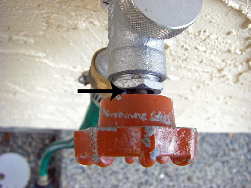

    if this is on the wrong forum, please move it to the right one!
    the exterior faucets are the kind for cold weather, so they are about a foot long - inside the house.
    the shaft the handlle is on has a little hole in it.
    on one, that is where the water comes out!
    what is wrong?
    thanks

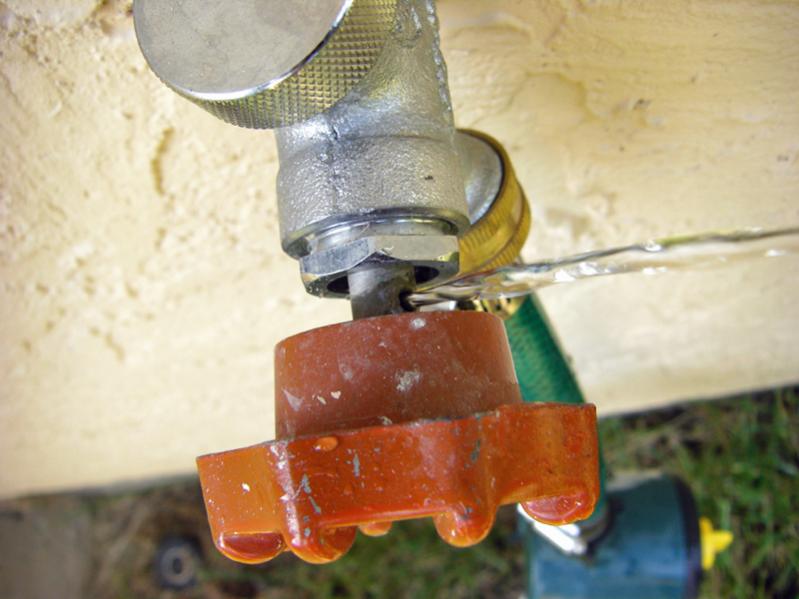

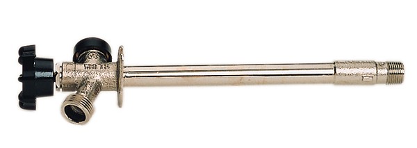

    A frost free sillcock uses a long shaft on the handle to turn the actual guts of the valve way at the other end. So, if it is leaking, it may need a rebuild kit to replace the sealing washer and or seat. Also, most frost-free sillcocks will still split if you happen to leave a hose on it with a closed nozzle...it then can't drain. If the shaft isn't sloped properly, it can't drain, and could freeze, too.
    12,437
    Sounds like new parts then.
    You should be able to order them from the manufacture.
    see fountain!

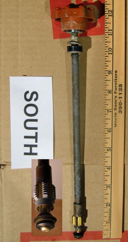

    DIY Junior Member anon125's Avatar
    Jul 2009
    British Columbia
    26

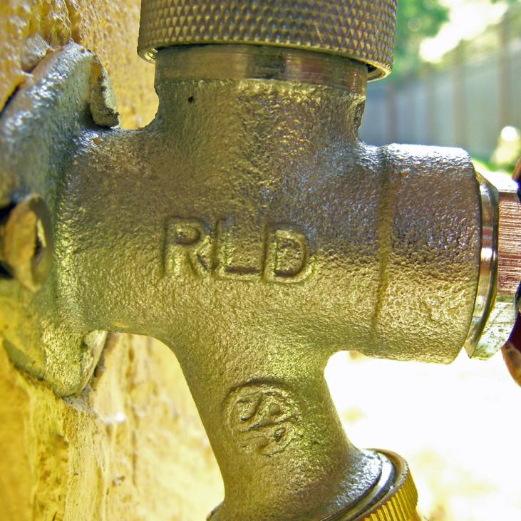

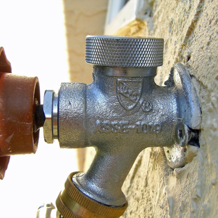

    do these help
    i suspect that rubber valve on top.
    thanks

    Jul 2009
    North Vancouver, BC
    1,580
    Annon I use similar exterior hose bibs on my projects here in Vancouver but prefer the 1/4 turn models. I suspect that that shut is missing a bleeding cap of sorts where you are getting the water stream from.
    Try bringing it to EMCO or Bartle & Gibson for replacement parts.
    Good Luck.
    Jul 2009
    British Columbia
    26
    Quote Originally Posted by anon125 View Post
    hose was removed - thanks
    does anyone know why the water comes out that little hole in the rod thingy?
    we replaces the end piece where the washer are. did not help.
    thanks all

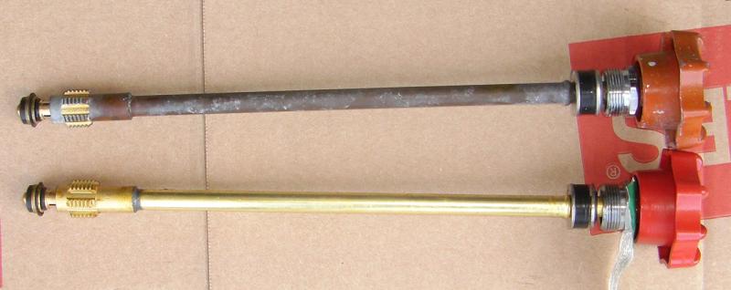

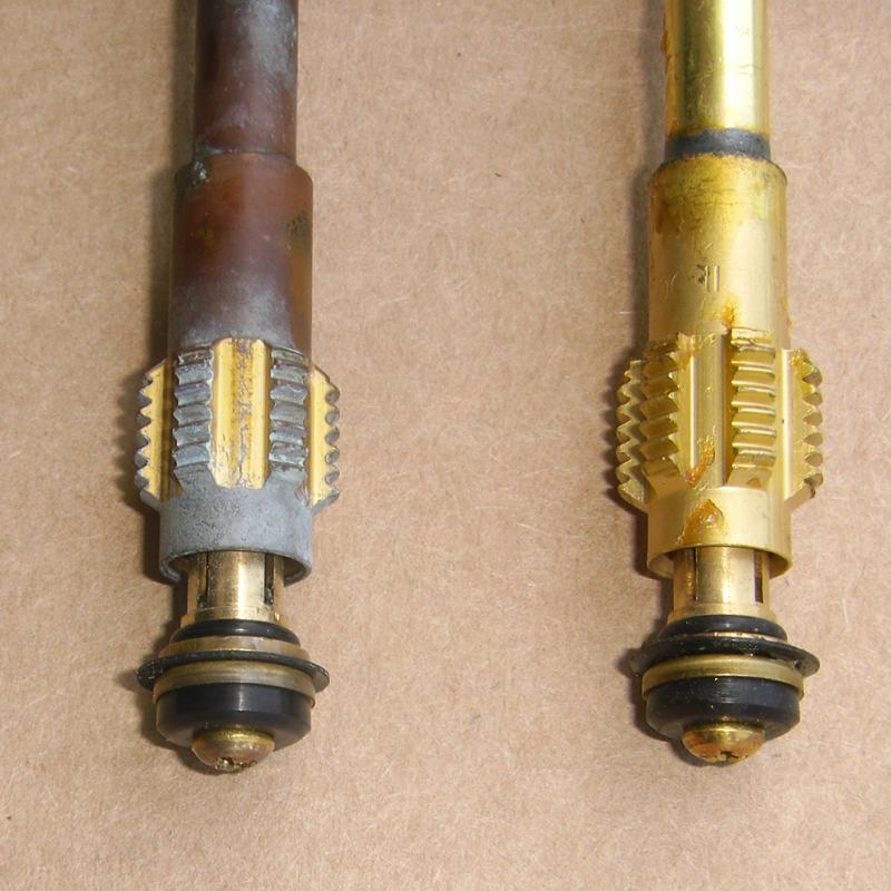

    Jul 2009
    British Columbia
    26
    Hello again folks!
    well we found a new inner piece and so far it works.
    it does not creak any more when opening/closing.
    the only difference i see is that the new one has grease on the deep inside thread.
    what kind of grease is it?
    could that have been the problem all along!
    thanks all
