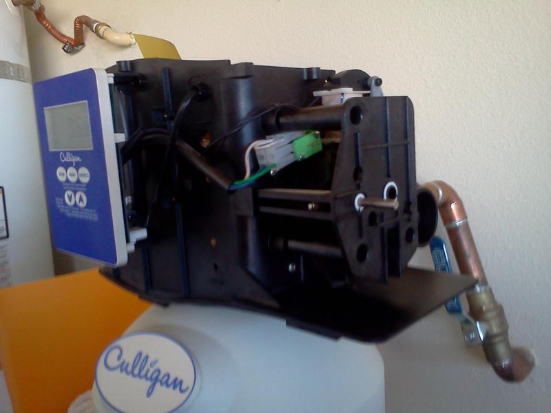

I thought I had a Platinum Plus, which is clearly the Fleck 7000SXT valve. The valve diagrams are exactly the same (as posted on the Fleck and Culligan websites). I now realize that I have a Platinum series valve. Culligan has apparently not posted a valve diagram for this model, which is extremely frustrating!
I have reviewed the cut sheets for nearly every valve made (Fleck, Autotrol and Clack) and none of them seem to match the look of this Culligan valve.
Does anyone have any idea who manufacturers this valve? I guess it is possible the Culligan made a special valve, but at least the internal parts are usually consistent (especially since the Platinum Plus is clearly the 7000SXT.
Thanks, JS

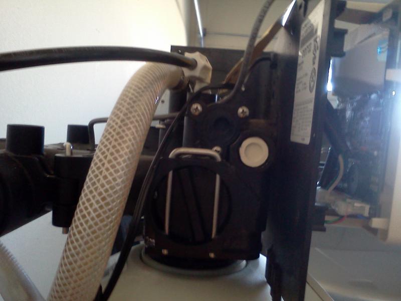

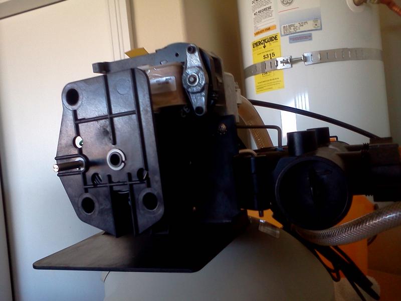

So I have been living with this dripping to drain water softener for months now, LOL, but it is getting worse. Can anyone identify this valve or any suggestions on how to get to the seal pack? I poked and prodded the thing by removing some screws and the plate on the left (which seems to give access to the OTHER end of the seal pack assembly. It seems like you need to take off the mechanical contraption on the right to access the correct end of the seal pack, but not sure. Its JUST about time for either a repair man or a new system...

Sadly, I vote for a new system. That is definetly a proprietary unit, not the 7000 variant. Your Culligan rep should be able to repair it easily and at a reasonable price. If not, then it is time for a change. (timely, just a couple weeks away, time for a change)
