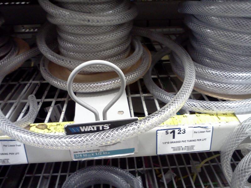

    I asked my supplier to supply me some more resin to put in the tank, so I wll be able to sleep at night
    I know there is no pressure in the line. Lets beat this drainage line horse to death. The supplier sent vinyl black tubing, NOT polyethylene (PE as you call it). I was thinking about using the braided PVC that they sell at the big box stores and that was installed on the old Culligan. It seems like the braided PVC will not kink nearly as easily at vinyl. Regarding PE, I could not find it locally in 1/2" ID dimension. The brine line is also not PE, but it seems to be black vinyl.
    I included some pics of each for reference. Is the braided PVC something good to use? The black vinyl seems cheap and it seems like it tends to kink really easily.

    So ya lost some resin.... it's not a big deal unless you think it is.
    The black drain line is the same PE tubing as the "clear" as you call it, unless you mean to use clear vinyl which is clear and a real no no.
    You do know that there is no pressure in the drain line right? The PE stuff is what you should be using although I don't like colored because you can't see the water in it. That goes for brine line too. Which is also PE.
    You should write on the label what BLFC and DLFC they installed since they didn't.
    To change the salt dose requires you to change the K of capacity number accordingly. You don't set the salt dose per cuft, you set the brine refill minutes for the total number of lbs. at 3 lbs/gallon of refill water. And if you are correct with the 30,400, you round the 30,400 up to 31 K and refill for that amount and round up any fraction of time.
    I sure don't like how far from the wall the softener is because of the over sized (1.25" valve) and extremely physically large 7000 valve.

    Your salt dose programing looks good to me although I didn't check the math.
    The opaque PE tubing in your pictures is what I suggested but they don't have the right size, but do in the 'black vinyl' 5/8" OD x 1/2" ID. Go somewhere else or order it online.
    The Funny Pipe sounds like black PE pipe. It has been used on the east coast for decades. Here it comes in various pressure ratings from 75 psi up to 260 psi. We use it to hang submersible pumps on to like 500+' and for irrigation and under ground water lines. The higher the pressure rating the thicker the wall the stiffer it gets. It's tough stuff but I wouldn't use it for drain line above ground. It is IPS (pipe) and your fittings are for CTS (tubing) as I explained before... The thinner stuff you have may be a much lower pressure rated version which means a thin wall that kinks. The black vinyl may be a thin walled low pressure rated PVC.
