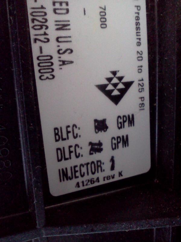

    Default BLFC and more!
    It looks like this supplier changed the DLFC size because the items on the back of the unit are crossed out with a Sharpie pen (see photo--kinda sketchy!). When I pulled out the BLFC it has "25" stamped on the plastic (TINY writing!), so maybe they switched it out. They are not open till Monday, so I will call them then. They have it programmed for a 40k unit (it is 2 CF) with a 16 min brine refill cycle -- so I assume with a nominal 2 CF system, it is using 6 lbs of salt per cubic feet because it is sending 4 gallons to the salt witch equals 12 pounds of salt (4 gallons at 3 lb of salt /gallon) (I think I finally get this.).
    What i DO need help with is setting it up for 4 bls of salt per 1 CF of resin. What so i set the "C" of the softener at if I set the BF is set to 10 (for 2.5 gallons of water to use 8 pounds of salt). Do I set "C" to 8 * 3800=30,400 or say 30? Do I need to adjust any of the other settings?
    I am also kinda stressing out about not getting 100% of the resin in the tank. Was it a big deal if I lost maybe one cup of resin in a 2 CF system? I don't really want to take it all apart again just to order some more resin and add it in (is that being crazy?).
    Sorry if I am rambling, but I hope these post help someone in the future. I wish this was not my first install as I learned a lot about both plumbing and of course softeners.
    Thanks again, JS

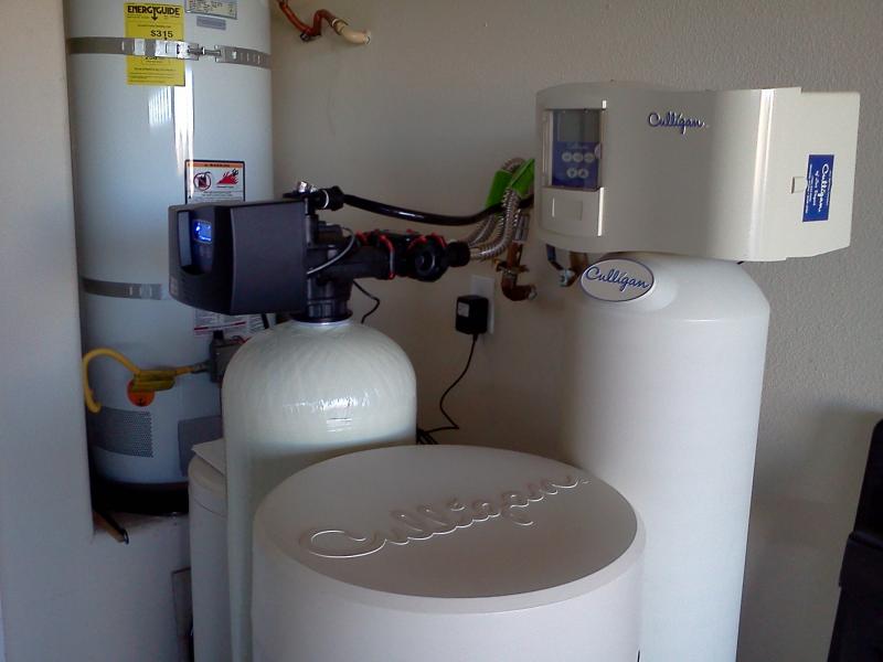

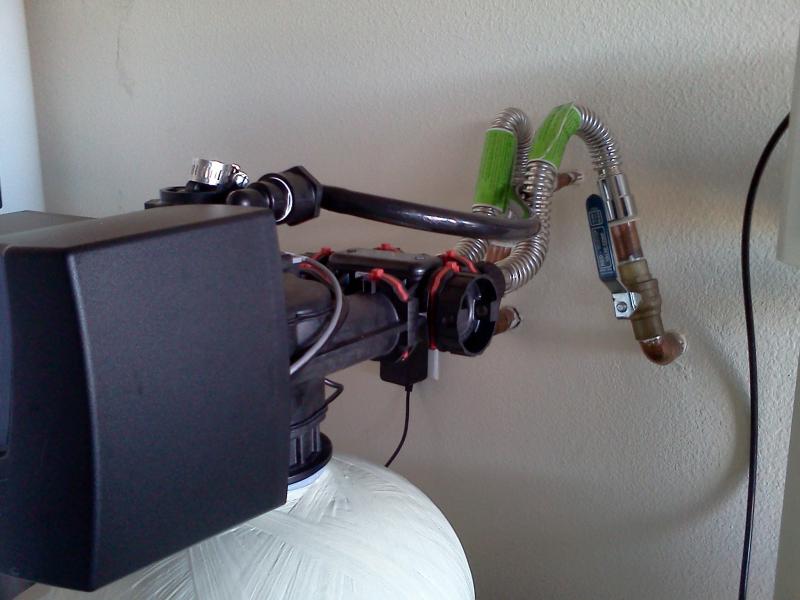

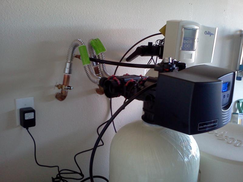

    Here are some photos of the 99% completed install (I still need programming HELP!). I want to change the junk black tubing out with some clear 1/2" ID hose that is less prone to kinking. I forgot to put the clamp on the tubing that connects to the Fleck, but it seems solid on the barbed connector anyway. The Falcon Stainless Steel push connects are nice, easy, relatively inexpensive to use and bend nicely into shape. You can see the cr@p Culligan waiting to be sold.
    JS

    So ya lost some resin.... it's not a big deal unless you think it is.
    The black drain line is the same PE tubing as the "clear" as you call it, unless you mean to use clear vinyl which is clear and a real no no.
    You do know that there is no pressure in the drain line right? The PE stuff is what you should be using although I don't like colored because you can't see the water in it. That goes for brine line too. Which is also PE.
    You should write on the label what BLFC and DLFC they installed since they didn't.
    To change the salt dose requires you to change the K of capacity number accordingly. You don't set the salt dose per cuft, you set the brine refill minutes for the total number of lbs. at 3 lbs/gallon of refill water. And if you are correct with the 30,400, you round the 30,400 up to 31 K and refill for that amount and round up any fraction of time.
    I sure don't like how far from the wall the softener is because of the over sized (1.25" valve) and extremely physically large 7000 valve.
  13. #88
    Nov 2010
    Maine
    2,940
    Why do the tanks need to be near the wall? Do they get lonely out there LOL The flexi supplies are keeping it further than the valve is. No problem with loosing 2 cups of resin.
  14. #89
    Jan 2012
    1,707
    Any chance you get to knock the 700, you will, even though I have already shown that the electrmechanical 5600 and 2510 are the same size. Fleck makes a 90 degree kit part # 61601 that will tighten that install up considerably. Would you like me to post a picture of my system? It is butted up against the wall.
    Why not start knocking the flex lines while your at it, like Tom said, they are the item that is causing the install to be so far away from the wall, not the "oversized 1-1/4" valve".
