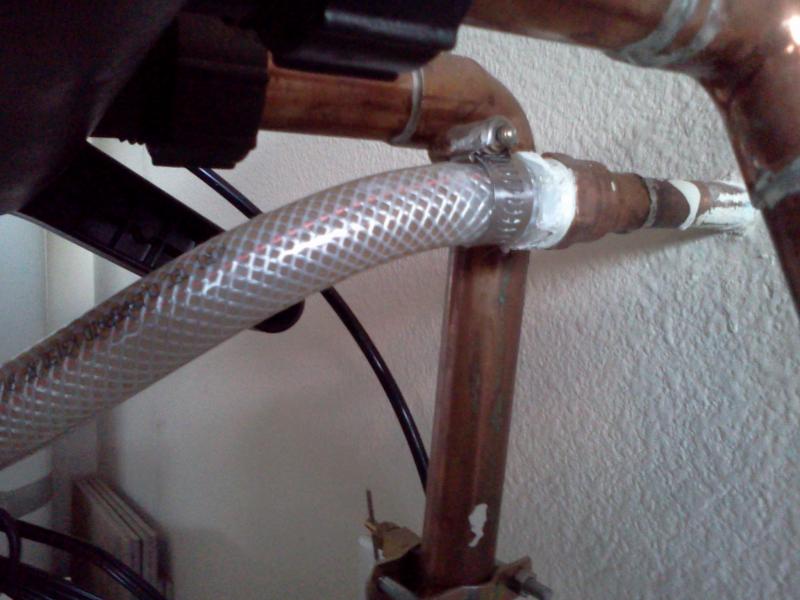

1. The existing Culligan is hooked up to a drain line with a 5/8" clear flexible tubing. I think the Fleck spec is a 1/2" tubing. I am unable to get the tubing off of the pvc connection that comes from the wall. Of course, I could cut the tubing after I disconnect the Culligan and see if I have to replace the pvc connection of if the 1/2" tubing could be connected to the existing pvc fitting. Any idea if the 5/8" existing clear tubing could work with the Fleck?

The 7000 comes with a 3/4" MIP connector. Considering the small DLFC size of 3.5 GPM, I would recommend running the drain in no less than 1/2". You can buy a 3/4" threaded PVC coupler from home depot for a dollar, and a 3/4" MIP x 1/2" barb to convert the drain easily.

Since you mention 5/8" tubing, the OD is 5/8", the same as 1/2" copper, PEX and CPVC. And the correct fitting is for 5/8" tubing and it is called 1/2" insert/barbed but... as in many things plumbing.... it is incorrect because.the ID is not 1/2", it is smaller by a bit. You should be able to reuse your fitting buy cutting it off if you buy a 3/4" x 1/2" reducer/bushing to screw it into. Or, buy a new PVC 3/4" male x insert fitting for the 5/8" you already have or the same size new tubing which should be coming with the new softener. Or maybe that new fitting will come with the softener also, I always included one with my softeners.
