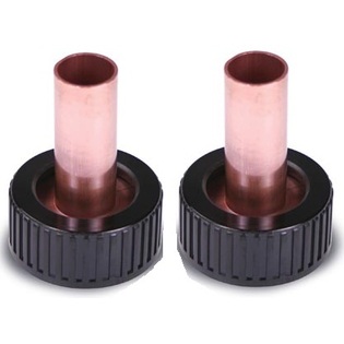

    Not to beat this horse to death...but, can the following be used to connect a Fleck? This is what the Culligan uses, and I can perhaps just move around the existing a bit (or get my plumber friend to do it)...Thanks,

    No, those are specific to Culligan. I am not a fan of that design, I have seen way too many of that design fail in the field. i am sure anyone who has a few years of field service has seen that design fail as well. Modern designs use an o-ring, not a flat seal. The pressure of tightening it and any minor misalignment put excessive stress on the plastic nut which can fail in a few years.
    Any luck on finding the 1" Flex connectors with John Guest ends?

    No luck finding yet, have to make some calls tomorrow. I saw it on a Falcon cut sheet, so I know it is out there. I hope they are not TOO expensive, but likely cheaper than pizza and beer for my plumber friend
    JS
    It is a newer part, I just got some in for testing a few months ago. Nice part, extremely high quality. Just be sure to use a pipe cutter on you copper, and I recommend using a green pad to clean the pipe prior to installing the John Guest end. Clean the pipe around the diameter, do not go up and down. They do not look cheap, but.. they are surprisingly affordable if my cost is any indicator. I am guessing they should be about double the cost of the 3/4" version. When you consider the cost of some copper pipe, a few fittings, etc, they are not that much different in cost.
    Send us a picture of the completed job, and good luck!
