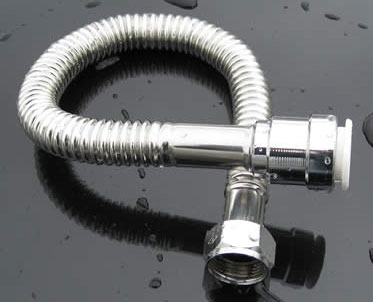

    Default Falcon
    It seems very difficult to find a 1-inch push on fitting. Loads of 3/4-inch. GRRR!
    JS
    JS
    It is a newer part, call the guys that have the 3/4" and see if they can get you the 1" version. Falcon part number is PTC1JG-1N and it includes nylon nuts which work better on plastic plumbing connectors.

    So I have a few options and seeking votes!!!
    1. use the new Falcon part with the 1" push connection and then 1" threaded to 1" 7000 valve.
    2. Use push fitting to transition pipe to 1" threaded, and use a 1" supply line (on each end) to connect pipe to 7000 valve.
    3. Use push fitting to transition pipe to 3/4" threaded and use a 3/4" supply line (on each end) to connect to 3/4" 7000 valve.
    I like 3, but worried that the transition to 3/4" might restrict the flow. Plus, 3/4" supply lines are easy to find. Option 2 is second. I REALLY like option 1, but I don't know if I can get those supply line (plumbing supply houses are such a PITA to deal with for homeowners for obvious reasons).

    Industry standard tank threads are 2.5" x 8 threads per inch. They are not pipe threads, they are straight threads and seal with an o-ring. Industry standard valves are 2.5" x 8 threads per inch straight threads.
    To unsolder the Culligan parts from the plumbing, you wrap a wet rag around the plastic part ad heat the soldered joint, take it off and immerse it in water to cool it. You can do the same wet rag thing for any copper soldered joint that you do not want to remove or heat up.
    You remove the control valve or its by pass valve from the plumbing connectors to do any soldering.

    http://www.falconflex.com/ Give them a call. Great group, we sell a lot of theor products and the quality is probably the best in the business. Good folks over there. They should be able to direct you to a company that can help you out. Definetly otion number 1.
