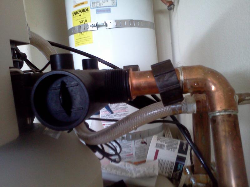

    Does anyone know how to determine the size of my Culligan softener? It is a 2006 vintage Platinum series.
    Also, I agree on the water efficiency. We actually use between 60-70 gallons per day between the two of us, and a bit more on weekends when we do laundry and are home during the day. We have low flush toilets, HE laundry, Bosch dishwasher, etc. This does NOT include irrigation use as that doesn't go through the Culligan.
    John
    Jan 2012
    1,079
    Can you see a part number/model number? You could measure the diameter and height and attach a picture, we could base it on that information as well. We need the picture to see if the system has a jacket so we can estimate the tank size.

    Does anyone know about the connections I attached from a picture of my Culligan (see attached photo). Can these type of connections work on the Fleck 7000 1-inch plastic bypass or do I need something different? Might be easier to sweat on new 1-inch threaded connections and then use the flexible lines to connect a new softener? Also possible to buy 1-inch push fittings with threads on the other side then use the flexible lines to connect the new softener (1-inch to 1-inch)?
    Name:  Vegas Culligan.jpg
