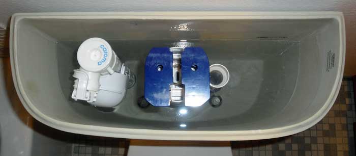

    But, my question about the Caromas (to Terry) is: How available are the replacement/repair parts for the tank? The inside of the Caroma tank looks pretty complicated and something being out of commission for weeks awaiting parts is useless to me, regardless of the water savings, especially in my case with only one bathroom.

    Inside the Caroma Sydney tank

    Caroma parts for the flush valve?
    They assure me that when parts are needed they will rob them from tanks.
    So far I haven't needed them.
    The fill valve is the plugged Fluidmaster version without the fill tube.
