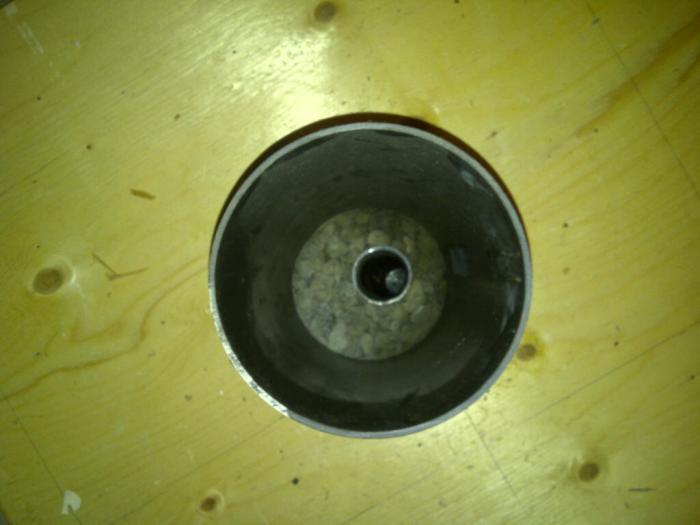

Hello Everyone,
Just registered, Great site!. I have a basement bathroom project that I am working on and it would be great to have some advise from the experts.
The rough in was done when the house was built (10 yrs old). I measured the drain to the finished walls at about 15 and 14.5 inches, however all the prefab corner shower bases or complete prefab showers that I have seen so far seem to have the drain location at 12/12 inches.
Don't understand if this was the standard back then and it is different now. The toilet rough-in is correct at 12 inches.

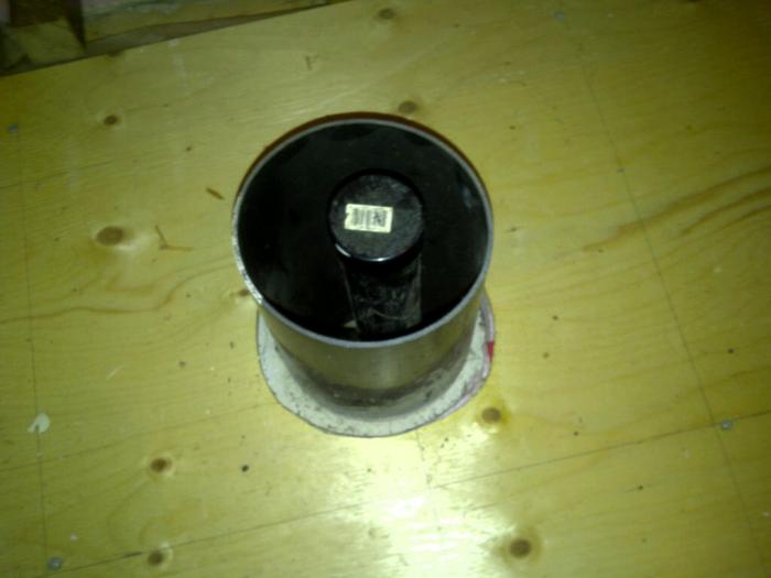

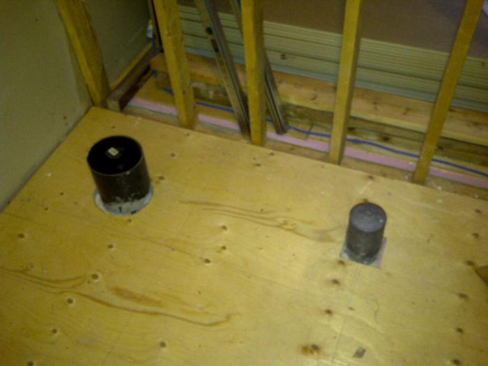

Is there solution to relocate the drain without breaking up the concrete. As you can see from the pictures the 2" pvc is not glued at the moment and there is some wiggle room but not 3", also there is a 7" pvc around the drain, don't know what this is for.
Thank You for your input.
33,603
1,042
The standard for a corner stall is usually 12" x 12" but there were, and may still be, some where it was 16" x 16" or 18" x 18", but they may be hard to find without a special order. It will be faster and cheaper to break the concrete and move the drain to the proper location. The larger pipe was to provide room for the shower's drain fitting.

It's generally best to have the drain in the middle of the shower, but it can be nearly anywhere. If it is in the middle, the elevation changes in all directions will end up about equal. When you move the drain from the middle, while maintaining the minimum of 1/4"/foot slope, since it looks best to have the pan even all around the wall/tile interface, the shorter section must have a bigger slope to account for the height change required for the longer section.

Thank You Everyone for all the input and options, I will follow up on this. I also spoke with a couple of local shower manufactures and they suggested that I could also build a base which would, by using a couple of elbows allow me to relocate the drain to align with the pan. Is this approach acceptable?
If so, the height of the base would depend I guess on the new location plus the height of the drain. What is the typical height of a drain fitting and are some better than others?
There is a limit on the total amount of change of direction you can have in a drain line...adding elbows to offset things is NOT a good idea. Maybe one, but to do that, you'll probably have to break up some concrete.
OR, make a custom pan, then the drain can be anywhere. If doing a tiled pan, it's easy to make it any size with the drain anywhere. This isn't really all that hard.

There is a limit on the total amount of change of direction you can have in a drain line...adding elbows to offset things is NOT a good idea. Maybe one, but to do that, you'll probably have to break up some concrete. ...
Jim I see plumbers off set above PTraps all the time. Often it's a couple 45's back to back to adjust a little or with a slight section of pipe for more space. Looks like quite a bit of vertical height there in the picture. I'm sure if she needed an inch or two of play she could achieve it without busting up concrete.
