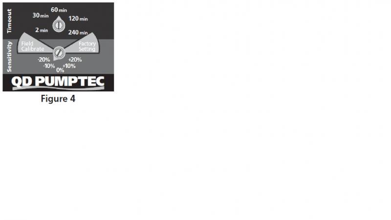

    Correct me if I'm wrong, but the amp draw on the pump should drop to a detectable level when it starts sucking air and cavitating. I understand your concerns are germane to the general topic of "Low Water Level Protection" particularly in an application where a well may frequently be pumped dry or the level dropped enough to deadhead the pump. The reaction time of the Pumptec (or your Cycle Sensor) should still be better than say, a low pressure cut-off in most situations.
    While repeated cavitation could/would shorten the life of the pump, repeated cavitation does not sound likely in this application. I think the OP is knowledgeable enough to detect aberrant pump behavior to notice and rectify the adjustment if not set sensitive enough.

    Thanks again valveman & LLigetfa!
    If I'm reading you two correctly, I would be better served if I implemented the "field Calibrate" function. Afterwards, I will be required to move the sensitivity pointer to a value between -20% to +20%. I spoke with a technical support individual at Franklin and he stated I should be fine at 0%. Any other setting could possibly trigger nuisance trips, or worse yet, miss an event altogether. I would value your input as well!

    Given that this is only for your sprinklers, I would err on the side of caution and opt for nuisance trips. My guess is there may be a concern of having something go wrong while you are away. A nuisance trip could have you returning to a brown lawn if a neighbor were not knowledgeable enough to reset same. Better to return to a brown lawn than a burned out pump.
    I have only a low pressure cut-off, originally as a Square D with the little lever that had to be held "just so" until the pressure returned above the trip level. When I got nuisance trips, Murphy conspired that I would be away from home and have to talk the wife through how to reset it. Now I have the EPS15/99 so nuisance trips are no longer an issue but the reaction time is long. If there was potential for my well to run dry, I would deploy something like the Pumptec or Cycle Sensor. The only time I was ever able to pump the well dry was in the beginning while I was developing it by over-pumping it.

    You only get one chance. If it misses the event, your pump is toast. Better do exactly like Franklin says, so if you have a motor failure, you can say you followed the directions exactly. Since you can’t see any numbers (amps) or know what number it took a “snap shot” of, I would still want to lift the pump out of the water to test it. Better it should miss the event while I am watching than when I am not.

    OK, I've think I'll do the following:
    1- Run the field calibrate feature
    2- When finished, set the sensitivity to +10%. Based on the documentation, this will increase the default trip sensitivity from 75% to 85% OR the Pumptec will now trip when the motor load drops to 85% of the "snapshot" taken during the field calibration.
    3- set the timeout feature for 60 minutes ........ it even resets itself.
    From here on out, only time will tell if all is OK!
    Thanks to all!
