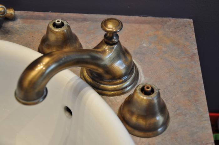

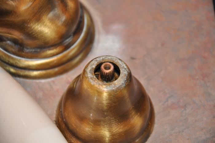

    Hi !
    I'm a newcomer on this forum who seems to have a lot of helpfull people !
    I have bathroom faucet handle that are leaking. I remove the cap but there's no way i can acces to retaining nut or anything that can allow me to change the catridge (if there's a catridge !). I don't know the brand of the faucet. You can see on my pictures that the brass thing that looks like a bell doesn't move at all.
    Can anyone help me with this ?
    Thanks !Name:  DSC_1274.jpg

    Plumber jimbo's Avatar
    9,001
    grab that dome and unscrew it
    21,395
    If you don't have enough strength to unscrew it, you can try a strap wrench (and some of those could damage things as well). Using most anything else is likely to damage the finish.

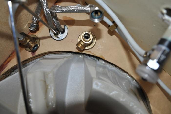

    I try very hard with a strap wrench and a friend and that dome doesn't move. There's copper ring under the sink that i've slacked but doesn't change anything. Once again there's a picture of what it looks like.

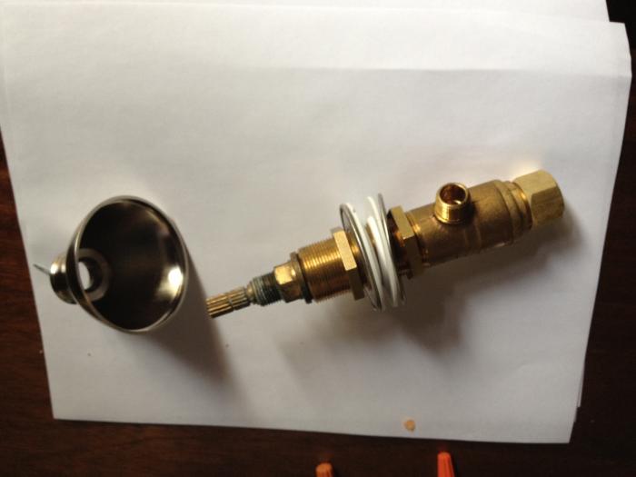

    That's a Rubinet faucet. You have to loosen the dome. It is possible that the installer did not install the faucet correctly and screwed the dome to the valve stem first and then tightened from underneath. That results in the dome being pulled down onto the deck and making it hard to turn. The bell is only supposed to be snug to the deck. The upper washer and nut inside the dome is supposed to hold the stem firmly to the counter top, not the dome. The top of the dome also should not be scratched up like that. When installed properly, the handle should not rub on the dome.
    Use a basin wrench to loosen the nut from underneath. That will release the pressure between the dome and the countertop . Hopefully then you can also get a better grip on the base of the dome and turn counterclockwise to unscrew it. You may need someone to grab it from below with a pair of pliers to keep it from spinning if it is stuck. Be careful not to grab the threads of the inlets or you will strip them. When using the pliers, grab the "back" of the stem.

    IF the entire faucet turns when he tries to remove the dome, that should mean that it is already "loose" but that the dome is corroded to the valve body. In most cases, that means that the dome will have to be damaged to remove it, since it will require the use of pliers or a wrench. Wrapping it with tape may prevent most of the damage, however.

    yep, if it's corroded, it will take brute force to remove it. You can try spraying some penetrating oil around the top of the dome and let is soak for a little bit. You can see from my picture where the dome screws onto the top of the cartridge. Either way, the dome has to be removed to get to the cartridge or to remove the entire faucet to replace it if there is too much damage.
    If you do get it out, you will most likely have to find a plumbing store or a higher end retailer that sells Rubinet for parts. Home Depot, Rona, etc. most likely won't sell the cartridge. It looks like an antique brass Rubinet Flemish. If you can, you should bring the old one because those cartridges have several lengths of stems for the handles. Even the one in my picture looks different than yours. It has a longer tip.

    Thanks for the help ! It doesn't show on my last pic but the nut under the counter is already loose. So maybe it's corroded like you suggest it. In fact I can move the dome and the entire unit upside down for something like an inch but it doesn't really help me to get a better grip. I've put some jig-a-loo but it doesn't seem to change anything.
