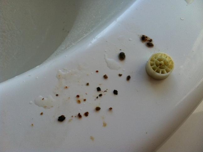

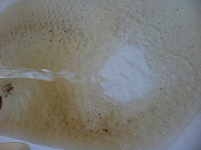

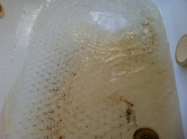

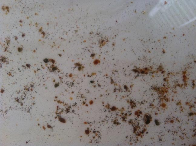

    Ok, so about 1.5 weeks after installing a temporary softener until my 7000SXT arrives, I turned on the water today and this came out of my tub faucet. Is this because the hard stuff built up inside my pipes is breaking up? I would turn on the cold water full blast, it would run clear for about 5-7 seconds, then pressure would drop and this junk would come out. I did this about 5 times, and was still getting gunk. The aerator piece in one pic is about the diameter of a nickel, just to give a size comparison.
    Just wondered if this is normal or not. I'd guess the pipe run from my softener to my tub is about 20' laterally, then 16' vertically of 3/4" copper.

    That is unusual. I would recommend opening the hose bib on the bottom of the hot water tank and see how much debris you have in the bottom of it. I usually see considerable hardness flaking when a softener is installed, white flakes and chunks falling off the plumbing and clogging the aerators, not usually dark chunks unless it is on galvanized plumbing. In my old house, the water ran red for over 6 months after I installed my softener. The Galvanized plumbing was over 80 years old so this was not unexpected. Try bypassing the softener and see if any more stuff comes out just to make sure you do not have a damaged lower screen inside the softener.
    6,790
    It looks and sounds like resin to me.

    What would the resin look/feel like? When I rub some of the orange particles left in the tub, they crumble, feeling kind of like sandstone that is very fragile. Easy to break up. But there WAS some gel-like stuff last night, felt sort of slimy and I was not able to pi

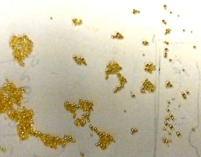

    Resin should be small shperical beads that are very hard. They should not crush between your fingers unless they are bad. I cant see color so I cant tell by the picture if it has resin in it, but see if this picture helps a bit. The resin in most water softener systems is an amber/orange color. Name:  resin.jpg

    Definitely not resin then. Nothing symmetrical nor consistent about this stuff. Random sized particles. And varying colors from grey ( looks like fine filings ) to orange to dark grey (some pieces as large in diameter as a pencil eraser ).

    I also think it only happens with the tub due to high flow rate. If I turn tub water on slowly, or use the shower, no gunk comes out. It's like the initial pressure surge is knocking stuff loose. But I am concerned with the fact that I could repeat this over 20 times last night, and again today. Seems like stuff should all be purged by now (minus the orange water I expect to happen for a long time).

    Are you sure you didn,t accidently leave it in bypass? I've seen similar dirt & debris when someone bypasses a filter or softener allowing the accumulated dirt & debris from the pressure tank into the plumbing system (especially if the tank is allowed to lose pressure, power loss, working on the system, etc.) If not, are you sure this temporary softener wasn't gutted?
