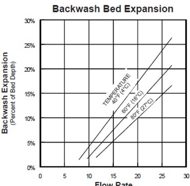

    The birm , pyrolox and filox are media that would take out the sulfur smell and are backwashing media? I want to makes sure my unit can properly backwash the media also, should i be concerened about the weight and how much i put in tank?
  4. #19
    Jan 2012
    1,707
    Birm should not be used for Hydrogen sulfide, so the common medias after that are pyrolox/Filox types of medias. I noticed the sticker on your unit shows a backwash rate of 7 GPM for the iron/hydrogen sulfide system. This is not adequate for pyrolox in many applications. What is the temperature of your water? Colder water requires less volume to expand a bed so a lower GPM may work. There are several other medias manufactured under different brand names that use less water and require less frequent backwashing, but Pyrolox or similar medias are the most common. A 10" tank should be backwashed at no less than 8 gpm, and preferably at 10-13 GPM.

    See the chart below for Pyrolox. As you can see, a 15% expansion of the media requires
    18 GPM per Sq. Ft of bed area at 40 degrees, or
    22 GPM per Sq. Ft. of bed area at 60 degrees, or
    26 GPM per Sq. Ft. of bed area at 80 degrees
    A 10" diameter tank has a sq. Ft area of .55
    at 40 degrees, the calculation would be as follows. .55 x 18 = 10 GPM backwash rate.
    at 60 degrees, the calculation would be as follows. .55 x 22 = 12 GPM backwash rate.
    at 80 degrees, the calculation would be as follows. .55 x 26 = 14-15 GPM backwash rate.
