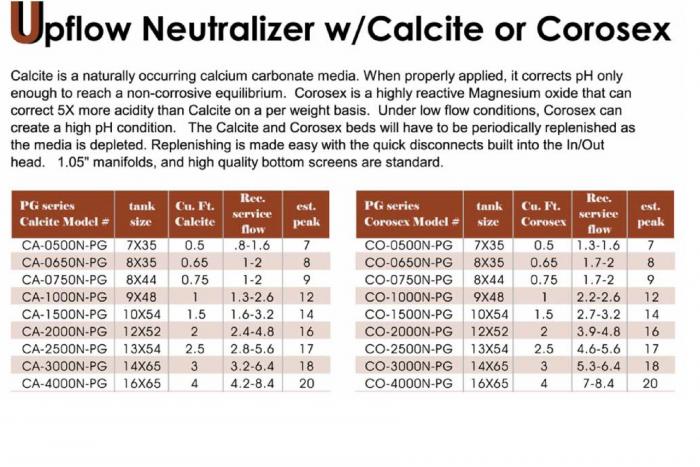

    I would like to install a acid neutralizer.
    I have read the posts here about backflushing vers non-backflushing systems. I understand that backflushing would probally be the better choice.
    Having said that, I am leaning toward a non backflushing. Installing a drain will cause my daughter asthma problems due to the chemicals in the sheetrocking mud and the dust from sanding.
    My questiions are:
    1) Can I buy a non backflushing unit and the convert later to a backflushing unit?
    2) I am on a well (being dug as we sppeak). I expect that the largest unit I could backflush would be 1.5 cubic feet. My house has three baths and three people. The current ph is between 6-6.5. When I get the test results back I will know more. Will this unit be adequate.
    3) I know that these unit add hardness. How much? At what point do I need to consider adding a water softner?

    1: It is very easy to convert a system from upflow to backwashing in the future. Be sure to ask here before you do it so one of the guys cn recommend the easiest conversion. I would recommend using a Stainless Flexible connector (Falcon) for the inlet and outlet as they will need to be reveresd when you install a backwashing head in the future.
    2: A 1.5 cu. ft. upflow calcite is rated for up to 3.2 gpm, but will flow much higher. The effectiveness of the neutraliztion decreases as the water flow exceeds the systems rating. For your well, a real water test and temperature are critical to properly size a calcite system. That being said, for most regular houses up to 3 bathrooms, a 1.5 Cu. Ft. calcite system is adequate.
    3. The amount of hardness that the calcite system will add is based on the pH, flow, temperature, etc. There are too many variables to make any accurate guess. The hardness only needs to be removed if you desire soft water. Hard water will have some negative affects on your appliances, water heater efficiency, etc. Submit your water test and I am sure we can get make some recommendations. If your well hardness is very low, then a couple grains of hardness that are added by the calcite may not be worth treating.
    Personally, I prefer the water I use to be below 3-5 grains. Anything above that and I recommend a softener.
    Name:  upflow calcite.jpg
    6,790
    phuges, I would not use Corrosex, it over corrects with your type pH. And I wouldn't suggest an upflow filter larger than 1.0. At least until I knew more about the well depth, how deep the pump was set if it's a submersible and what gpm it was. If a deep well jet, how deep the foot valve/J-body is, or if it was a shallow well jet pump and what gpm any jet pump was.
    I say that after years of treating a lot of acidic water in PA which has some of the most acidic water in the country.
    And I would go the backwashed type filter now instead of later because it's the right thing to do plus the cost of a separate control valve being much more than when bought as part of a filter.
    Since the well is being drilled now, there may not be much dry wall demolition to install a drain line for the filter (and possible softener) and dust can be minimal by using a shop vac during sanding. Or maybe run a 3/4" ID (or1" ID) drain line outside now that both can use as the driller brings the water line into the house.

    Gary, you are correct. That is why I mentioned the calcite and not the corosex. The chart is from my catalog page, and corosex is usually used for acid neutralization in industrial processes. We use it during dairy and pharaceutical ultrpure water system passivaton processes or cooling tower and steam boiler chemical acid descaling. We run the waste water to the drain through the corosex so we dont exceed the lower pH limits of the sewer system. For a well system, it is not recommended. It has a tendancy to over correct and create a diluted form of Milk of magnesia. Great if you are trying to cleanse your bowels. Due to "grey water reuse" rules, it is not legal to do in many states, but... you can run the backwash from the calcite system to the lawn. Be sure to test it for a little while to make sure it doesnt have a negative affect on the foliage, but it really shouldnt.
    6,790
    The only time a homeowner should use Corrosex in an AN filter would be as part of a mixed bed due to a lower than 6.0 pH. And then only up to 20% of the total volume of mineral, and that may be too much. Otherwise there is serious over correction and potential water quality problems.
