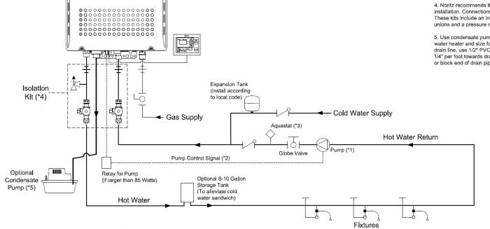

I have been noticing the fan (I assume it is the combustion air fan, don't know if there is another fan in this thing) runs alot. After a burn cycle is done the red light goes out, and the fan runs for awhile and then turns off. But a few minute later the fan will fire up again, even though there is no call for hot water. Then it will do it again a few minutes later.
Is this normal? Seems like an awful lot of fan useage to me.
I do have a hot water recirc with dedicated line and check valve on the cold water inlet side of the return. However, this is a Redytemp that is on a timer (total of about 2 hours a day), and a manual switch. The pump is not running when I observe this behavior. However, the cold water inlet line can be warm if the recirc has been used recently. Not sure the recirc is causing the fan to run given the pump isn't on, but thought I should mention it just in case.
Maybe that check valve is interacting with expanding/contracting water on the cold side just enough to trigger the water flow sensor and false start the tankless?
Edit: this is the NRC-1111DVNG

No, I don't have a thermal expansion tank. So my guess about expanding/contracting column of water may not be that far off? The water flow sensor is being triggered? I assume you are referring to a tank in the hot side output? I suppose this item will not improve the speed of hot water developed at the tap!
I don't recall in the installation instructions a thermal expansion tank is mentioned. :confused:
edit: maybe the hot water speed will not be affected if the tank is in parallel with the output, it will just allow expansion/contraction but not require the hot water "flow through".

Is the thermal bypass the valve that blows over-pressurized water (typically onto the garage floor) out of the hot side of the water heater if there is some unforeseen problem? I've never seen an installation that does not have this. They are required by code, of course. But this valve is supposed to never operate except in emergency circumstances. I have a pressure regulator at the inlet to the house, far from the HWH.
I checked with Noritz, and they claim I should have a check valve in the recirc pump output to the HWH cold inlet, as well as a check valve in the HWH cold inlet (which I already have). And an expansion tank between these two valves and the HWH inlet. I guess water is moving, expanding, or thermosiphoning and causing the HWH to false start.
Code may or may not be up on tankless systems, but generally an expansion tank is required when you have a PRV. Since a tankless only runs when there's a demand, you don't have a large tank of water that could be being heated and expanding.
If you do install an expansion tank, they are not designed for installation on the hot side. If you do put one there, it won't last as long as where it is designed to be (on the cold side).

That is not what I mean by thermal bypass. That is actually part of the PRV. If you look at the diagram, look at the cold water supply, the first thing inline is a PRV which you will note is shown as a one way switch.
I see. The 'one way switch' is a check valve, which is a one way switch for water. I should have included the legend from the Noritz diagram.
So yes, I will need an expansion tank as discussed. I am also experiencing some odd temperature fluctuations (water cools noticeably) in the shower. I do not think I can attribute this to either the Toto thermostatic shower valves or the temperature regulation of the Noritz TWH. I think that recirculation loop is moving cold water into the hot water line by virtue of lack of a check valve at the recirc pump outlet in my system, as shown in the diagram.
I'll get it fixed shortly.

I see the Redytemp 4000D circulator is supposed to have a check valve built into the output, so I should not need to install one. In fact, my system should be configured correctly except for the lack of an expansion tank. Which, to be honest, I do not see as likely to be responsible for my issues described above.
I suspect there may be a problem with the check valve at the circulator output. I will diagnose this by closing the valves at the input and output of the circulator pump and see if the symptoms go away.

I closed the recirc pump valves and unbolted the pump. The HWH no longer runs when hot water is not being called for. Blowing on the check valve does not reveal any problems, but I don't think that is as conclusive a test as removing the recirc pump and closing the circuit.
The built-in check valve is a cheesy plastic job. I wonder if that is the problem? There are brass check valves available, I wonder if I should use one of those instead of the built-in cheap valve?

OK, this is one of those classic operator error moments. The Redytemp unit is cleverly designed to accept any 120V timer to operate the unit on a a schedule, as well as pushbutton from a momentary switch next to the disposer at the kitchen sink.
The problem turned out to be nothing more than the timer set to "on" rather than "auto". Doh!
