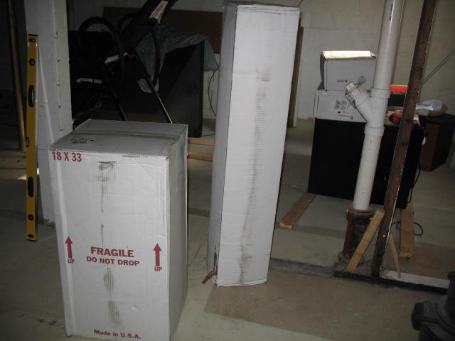

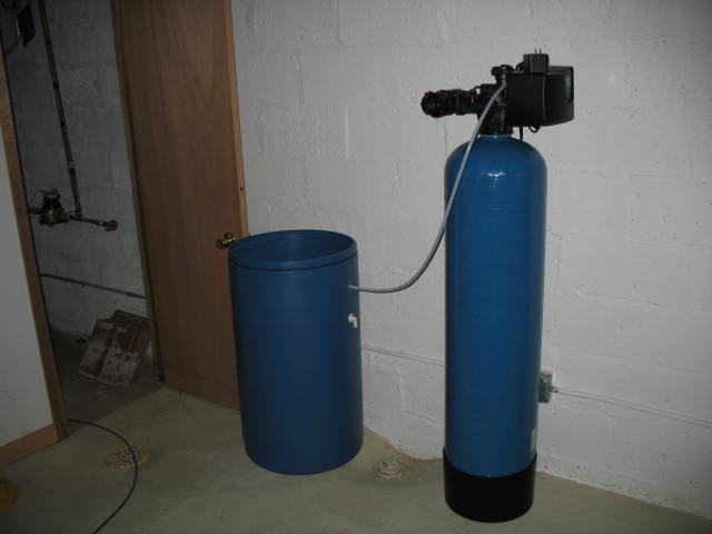

    i ended up getting it for ohiopurewater.com, $630. but idk if i have these things = gravel base, an upper distributor basket.
    i now have it, it comes in 4 boxs. you can see them in the 2nd pic. this thing is a good bit larger than i thought it would be = but not a problem. the plastic bypass, this thing seem substantial . its plastic, but does not feel cheap.
    now, some questions. assembly instructions pretty much do not exist, at least not in the package. so i will have to look online. but i will ask here.
    1. the long tube in the brine tank. that just pushes up into the control head ? seems thats all it does.
    2. on the bottom end of this tub, there is a , umm, idk what to call it. but there is 2 in the package. what is the other for ?
    3, in pic 1, see the white fitting on the side of the salt tank, there is one on the control head. but there is no hose to connect them.
    4. the in/out fittings. will HD etc have adaptor fitting to fit ?
    5. the float, it fits. but says i may need to trim it. trim it for what ?
    thanx

    i'm a dope. i overlooked that they had email me a installation guide. and it looks good, so far.
