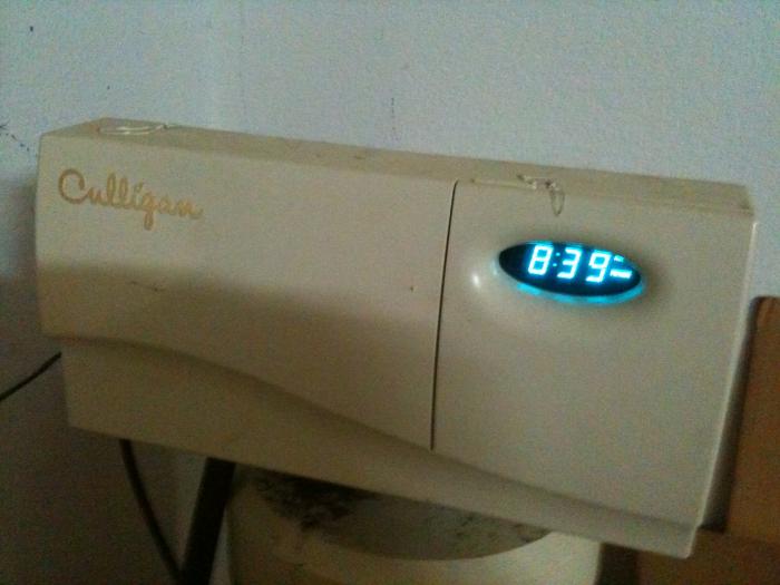

    Dallas, TX
    Default Culligan Gold/Silver Regenerating daily
    I have a Culligan Gorld or Silver softner. It regenerates every day. The #8 screen says "08". If I'm reading the manual right, this means it should regenerate every 8 days. I guess I could have the "soft-minder" - how can you tell if it is the soft-minder or time-clock model?
    Dec 2009
    Alaska
    1,330
    Culligan used a few different controls on the gold or silver systems, so not sure about the number 8.
    Are you hearing it clean every night?
    Photo would help.

    Yes, it cleans every night. I'll upload some photos tonight. Screen #8 is supposed to be the "regeneration interval", which should be Gallons (divided by 10) if unit has a soft-minder. If not, it should represent # days to regenerate.

    I don't think I have metered. Screen #8 (regeneration interval) says "8". Display is not changing.

    It is possible that the control board is locked up, as you should be able to step it through the different stages of the programing.
    DIY Junior Member Dankon's Avatar
    Apr 2012
    Dallas, TX
    I am able to step thru the different stages of programming ok. On step# 8 of programming is the "regen interval". It now displays "08" for that. Here's a link to the owners manual: http://www.eculligan.com/support/gold2002.PDF The programming step I'm refering to is page 10, step # 8.

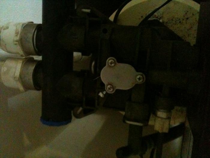

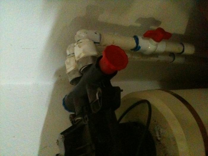

    Pretty sure it's an older Gold Series model without the flow meter. I have included a couple of photo's (sorry for the poor quality). Name:  IMG_0691.jpg
Size:  35.7 KBName:  IMG_0693.jpg
Size:  38.6 KBName:  IMG_0695.jpg
    Dec 2009
    Alaska
    1,330
    If it is the metered then there is a cable going back to the out side of the valve body right at the bypass valve on the blue side of the handle.
    Send a pm, there is a manual that has more on that board, might need to be reset.
    Apr 2012
    Dallas, TX
    No cable from the blue side of the valve. I am new to the board - how do you send a PM?
