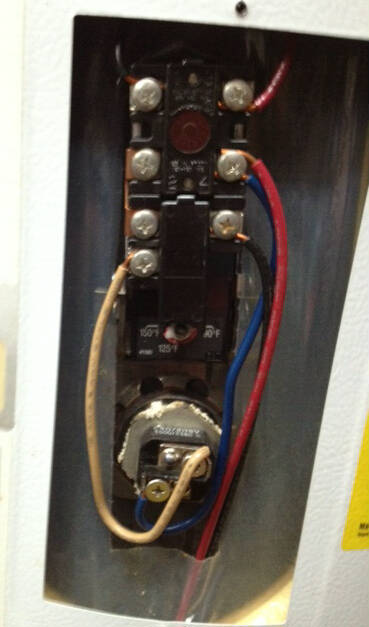

My hot water heater has a mind of its own.
It used to only happen when we went on vacation but now it's about every three weeks.
The water will get really hot and the over temp safety will trip. I will have to wait for it to cool and then reset. This will go on for five or six days and then stop. It will then work normally for several weeks.
It is a dual element electric.
How do I fix?

Sounds like a defective t-stat. If it isn't detecting the temperature correctly or thinks the setpoint is higher than it is, the elements will continue to run and heat beyond the temperature setpoint. What ballvalve is saying is that the parts are cheap and easy to replace on an electric WH. You aren't out anything but a little time and money to replace the t-stat(s). It will probably fix it. If it doesn't, you at least know that it wasn't the cause.
An electric WH is nothing but a power supply feeding it, a couple t-stats to control the elements, usually a pair of elements for heating, and an overtemp limit trip (for safety). They are simple devices and are cheap to repair (outside of a failure of the tank itself).

Have a plumber test ALL the components. A failing element can cause the problem, but so can a loose screw on the thermostat. IF you just start replacing parts, you may still NOT cure the problem.

If the element is grounded it can run all the time until it fails. This can/will cause the heater to over-heat and the high limit to trip. I doubt thats ur problem.
The thermostats should fit tight against the tank. The insulation should be in place over the thermostat and the exterior cover panels should also be in place.
I suggest the upper and lower thermostats match in temp settings.
You probably have a bad upper or lower thermostat.

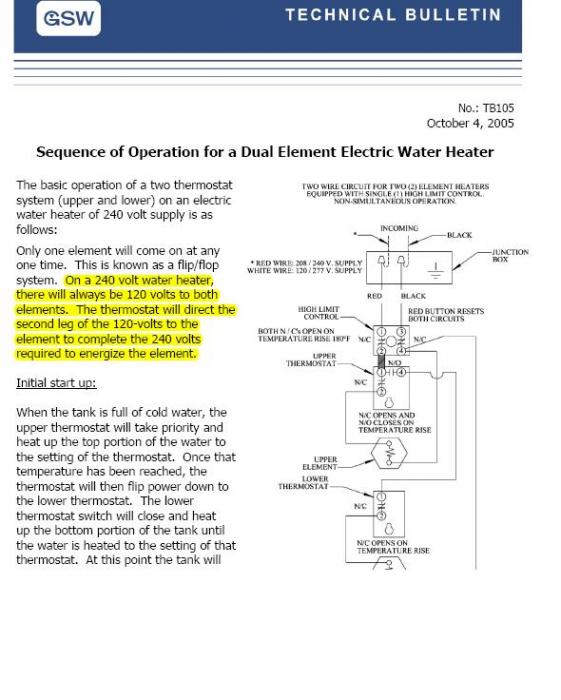

I think you guys stretch reality. As far as I can see the thermostat is a double make and break circuit. If you take a metal tea pot and ground it, then stick one hot lamp wire in it, you get a blown breaker.
http://waterheatertimer.org/How-to-wire-water-heater-thermostats.html
test your element when the thermostat is "off" NO NO NO power at any wire on the element - duh, otherwise you would have a 120 volt element that would last for years like Mr. Electricals 240 volt light bulbs. And it would heat the water perpetually. Pretty simple, Watson.
"blown elements" heat at a reduced pace until they trip the breaker BECAUSE they are 2 pole switches that break both wires. Wanna work on a water heater with one hot wire always on the element?
WRONG. WRONG. WRONG.
Look at the wiring in the link you provided.
There is ALWAYS a hot leg at each element (red and blue line in the diagram in your link) unless the OVERTEMP BREAKER POPS i.e. ECO reset trips.
In the diagram in your link;
If WH is not up to temp setting, then upper thermostat only switches left leg through T2 to upper element left screw or through T4 to lower element left screw to complete a 240 Vac across the element.
Unless overtemp reset trips, you WILL have a 120vac phase at one of the element lugs ALL THE TIME.

I dont know what part of Bangladesh you get your heater switches from, but my meter just showed NO POWER to either element when not calling for heat.
You don’t have to get rude you know....
My GE Dual Element water heater is wired exactly like the one in your link, wire colors and all.
I just put a meter across the upper element with water heater up to temp and not calling for heat.
Across the two lugs on the upper element I read 0 VAC, i.e. element is NOT heating the tank.
BUT, When measured from either element lug to GROUND the meter reads 121 VAC...BECAUSE terminal "L4", where the BLUE and RED wires are connected, is HOT ALL THE TIME!!!!
They are single throw double pole switches.
The upper element and lower element thermostats in your link and in my Water Heater are Single POLE, Double Throw, SPDT Look at the attached diagram of the upper element thermostat you linked to and compare it to this SINGLE POLE Double Throw.

Maybe this will help: http://eet.canton.edu/~eet/Sequence%20hot%20water%20heater.pdf
Notice that power from one leg goes to one side of EACH element (after the high temp limit switch which DOES remove power from both legs, but it's the only thing that does). The thermostat determines which element and when it applies power to the other side of the selected element to actually heat the water.

Here is the sequence from Jim's link from the State University of New York, Canton, Electrical Engineering Technology Department. I highlighted the description about there ALWAYS being 120 VAC to both elements.
Notice that while Canton is pretty close to Canada, it is nowhere near either Bangladesh or Mexico. :eek: :p
This description agrees with my understanding of the circuit diagram and with the readings taken with my Fluke Meter.
